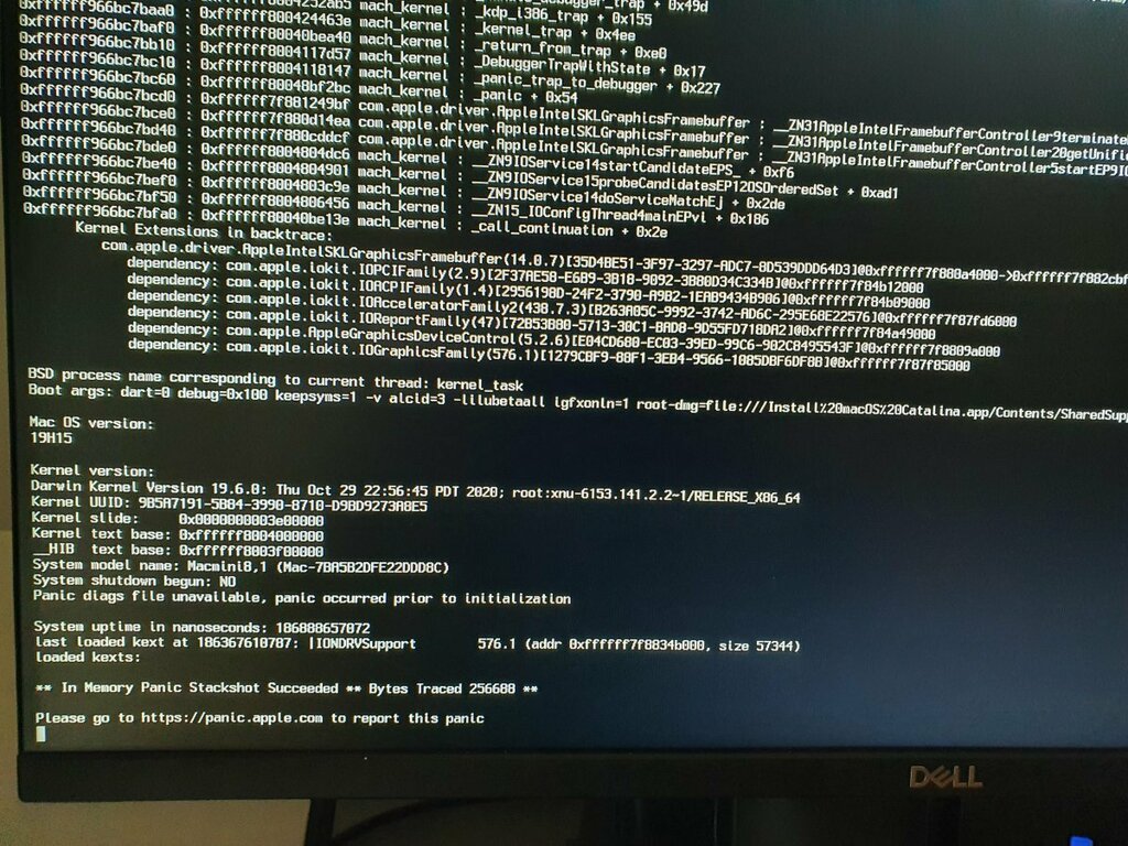

Ponghetto Posted March 4, 2022 Share Posted March 4, 2022 Hi I've the same pc configuration as listed here but installation doesn't start. First I've formatted usb, downloaded Catalina image,prepared usb with 2 partitions. used mountefi and copi on EFI partition your EFI. insert usb into Precision, see Install Catalina os from usb with clover, but it remain in Apple logo could you help me to solve this problem? Thanks Link to comment Share on other sites More sharing options...

Ponghetto Posted March 5, 2022 Author Share Posted March 5, 2022 here the print screen error Link to comment Share on other sites More sharing options...
Moderators Jake Lo Posted March 5, 2022 Moderators Share Posted March 5, 2022 Graphics issue. It doesn't look like you're using the same file as the OP attached. Your error shows you're using Macmini8,1 The OP attachment shows iMac17,1 Link to comment Share on other sites More sharing options...
Ponghetto Posted March 6, 2022 Author Share Posted March 6, 2022 I've changed config.plist with imac17,1 In this pc i've got an esterna nvidia k620 and an integrated intel 500 I check settings again Link to comment Share on other sites More sharing options...
Administrators Hervé Posted March 6, 2022 Administrators Share Posted March 6, 2022 Please check and post your system’s specs because: nVidia Quadro K620 is Maxwell and therefore unsupported beyond High Sierra (with which it requires the nVidia Web Driver). Intel HD500 graphics is a low-end mobile iGPU of low-end Apollo Lake SOC platforms and unsupported under macOS. It cannot be what’s fitted to a Skylake workstation such as the Precision Tower 3620. 'should be something more like Intel HD530 (i3/i5/i7 Skylake CPU) or HD P530 (Xeon E3-12xx v5 Skylake CPU).  Once you know what hardware you have, which is a pre-requisite, you may consult this thread: https://osxlatitude.com/forums/topic/8238-supportedunsupported-gpus-graphics-cards  Link to comment Share on other sites More sharing options...
