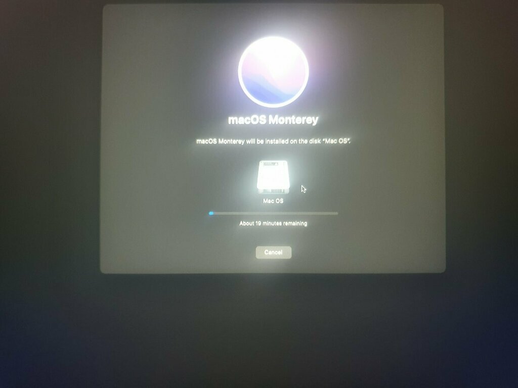

lamkent Posted March 14, 2022 Author Share Posted March 14, 2022 EFI_DELL.zip Hello @Baio77, Thank you help. I tried your EFI and changed some config. It works well before installing. It stuck here. Do you have any info for this? Quote Link to comment Share on other sites More sharing options...
Moderators Jake Lo Posted March 14, 2022 Moderators Share Posted March 14, 2022 What model drive does it have? Quote Link to comment Share on other sites More sharing options...

Moderators Jake Lo Posted March 14, 2022 Moderators Share Posted March 14, 2022 mzvlb256hbhq-000l7 = Samsung PM981 That would be one of those unsupported NVMe drive Quote Link to comment Share on other sites More sharing options...

Moderators Jake Lo Posted March 14, 2022 Moderators Share Posted March 14, 2022 You can try adding NVMeFix.kext but not guarantee to work. Even if it does install it'll still have issue. I see it's already in your EFI, you could try updating it to the latest version 1.10 Best to replace it with a known supported drive. Quote Link to comment Share on other sites More sharing options...
