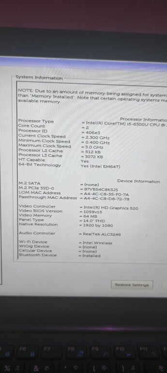

tanzahost Posted May 11 Author Share Posted May 11 Processor: Intel Core i5 7th Gen Processor 2.6GHz Storage: 256 NVME SSD (TOSHIBA) Ram: 8 GB Screen: 14” FHD Screen Display Graphic : Intel HD Graphics Ports: USB 3.1 × 2, HDMI 1.4 Quote Link to comment Share on other sites More sharing options...
Administrators Hervé Posted May 11 Administrators Share Posted May 11 @tanzahost please refrain from posting in multiple threads about the issues you encounter hackintoshing your 7480; I suggest you stick to this one. Please post the exact model of CPU, that'll determine your exact iGPU model. Intel HD graphics is insufficient. Look it up in your BIOS info. Quote Link to comment Share on other sites More sharing options...

Administrators Hervé Posted May 11 Administrators Share Posted May 11 A simple line stating Intel i5-6300U CPU with Intel HD 520 graphics would have sufficed... Anyway, so it's a 6th gen Skylake model, not 7th gen Kaby Lake as you incorrectly stated; not a small detail or small difference for sure... As they state in the Dortania guidance: Quote Link to comment Share on other sites More sharing options...

Administrators Hervé Posted May 11 Administrators Share Posted May 11 Looks like you re-used an existing EFI folder without modifying it to match your own hardware. You have an Intel wireless card so all those patching kexts for Broadcom Bluetooth are useless and you can remove them. Your config also contains many useless/inapplicable, sometimes overriding, properties injections; they're mostly cosmetic and should not cause problems but it'd be preferable to remove them to avoid all possible confusion and doubts on the matter. Better to stick to the essential and a minimal set of configuration before jumping into fancy stuff. Your boot issues probably result from incorrect quirks being set; do try and follow the Dortania guidance for Skylake laptops: https://dortania.github.io/OpenCore-Install-Guide/config-laptop.plist/skylake.html Quote Link to comment Share on other sites More sharing options...
