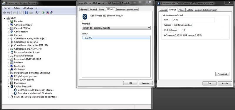

smile.gifUse: DW360, CSR chip (here on D630 X3100 under Win7)
To activate/deactivate BT radio, simply right click on blue BT icon in Windows task bar and select accordingly in the menu.
