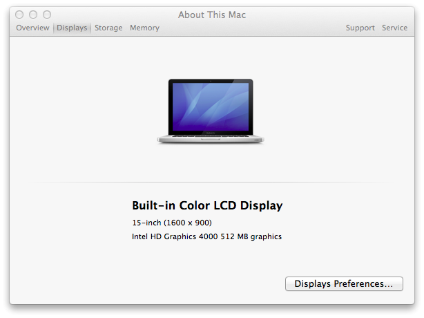

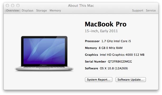

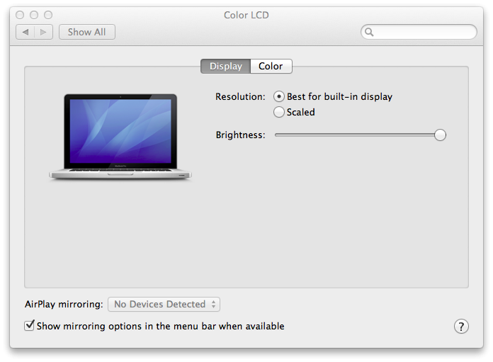

kvonlinee Posted April 29, 2013 Share Posted April 29, 2013 Hi all! I got a dell inspiron 17N5721 cpu is I5-3317U with HD4000 I try to put osx 10.8 on it. and I could get HD4000 show up as in "about this mac" but the built-in display have a little light and I can't see anything from the built-in display that. I know it got HD4000 512 MB by share screen connect and it show nice desktop. please hlpe me, what can I do and where can i start. thank you very much first Link to comment Share on other sites More sharing options...

kvonlinee Posted May 16, 2013 Author Share Posted May 16, 2013 hi everyone! now it run 10.8 and I could not get any update success so it is ok of me. with the hardware I swap the mini intel centrino 2230 for HP Atheros AR5BHB92-H AR9280 it reconisg as airpot extreme. what is work: Hd 4000 full acceleration qe/qi trackpad with 2 fingers scrolling Fn audio (volume up and down), brightness control Fn key, wireless switch on or off. webcam mic audio with voodoohda 2.8.2 (internal speaker and head phone) sleep and wake respond dvd drive usb read both usb2 or usb3 what is not work: HDMI (both video and audio) don't know or has not test: LAN card reader battery note: when display go to sleep and when it wake its brighter. Extra.zip Link to comment Share on other sites More sharing options...
