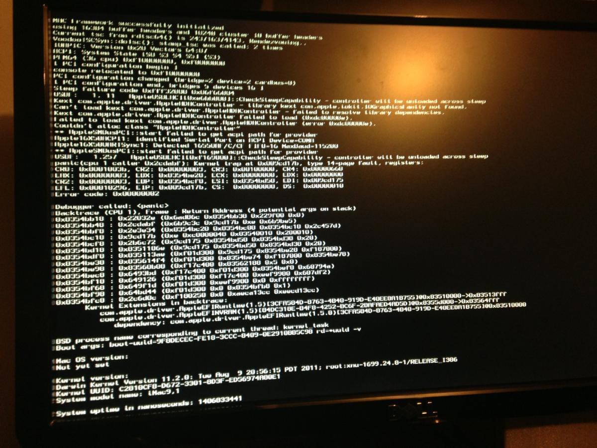

cooxl231 Posted June 25, 2013 Share Posted June 25, 2013 Hi everyone. I managed to receive a Optiplex 745 and I am trying to install OSX 10.7 on it but am running into problems. I followed the normal procedure for creating a usb install disk with the proper bootpack files for the optiplex 745, but as its loading all the kexts and while loading in verbose mode, it kernel panics. here is a image of the kernel panic. It looks like I need to remove the AppleEFIRuntime and EFINVRAM kexts? maybe specific bootflags need to be used? system specs; Optiplex 745 8gb ddr2 ram 160gb hdd radeon x1300 core 2 duo e6600 Link to comment Share on other sites More sharing options...
Administrators Bronxteck Posted June 25, 2013 Administrators Share Posted June 25, 2013 need to replace your chameleon boot file with 2248. your trying to boot into arch=i386. Link to comment Share on other sites More sharing options...
