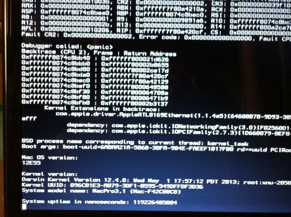

Are you sure it's an Intel 10/100Mb Ethernet port? The message above indicates Realtek... What does your KP message show?

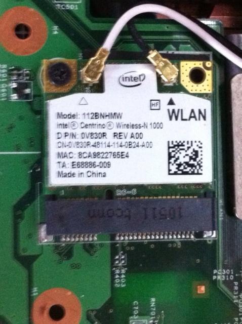

However, if you guys have an Intel wireless card onboard, either disable it in the BIOS or take it out; they're not supported. Intel cards often lead to KP when booting the Mac OS installer.

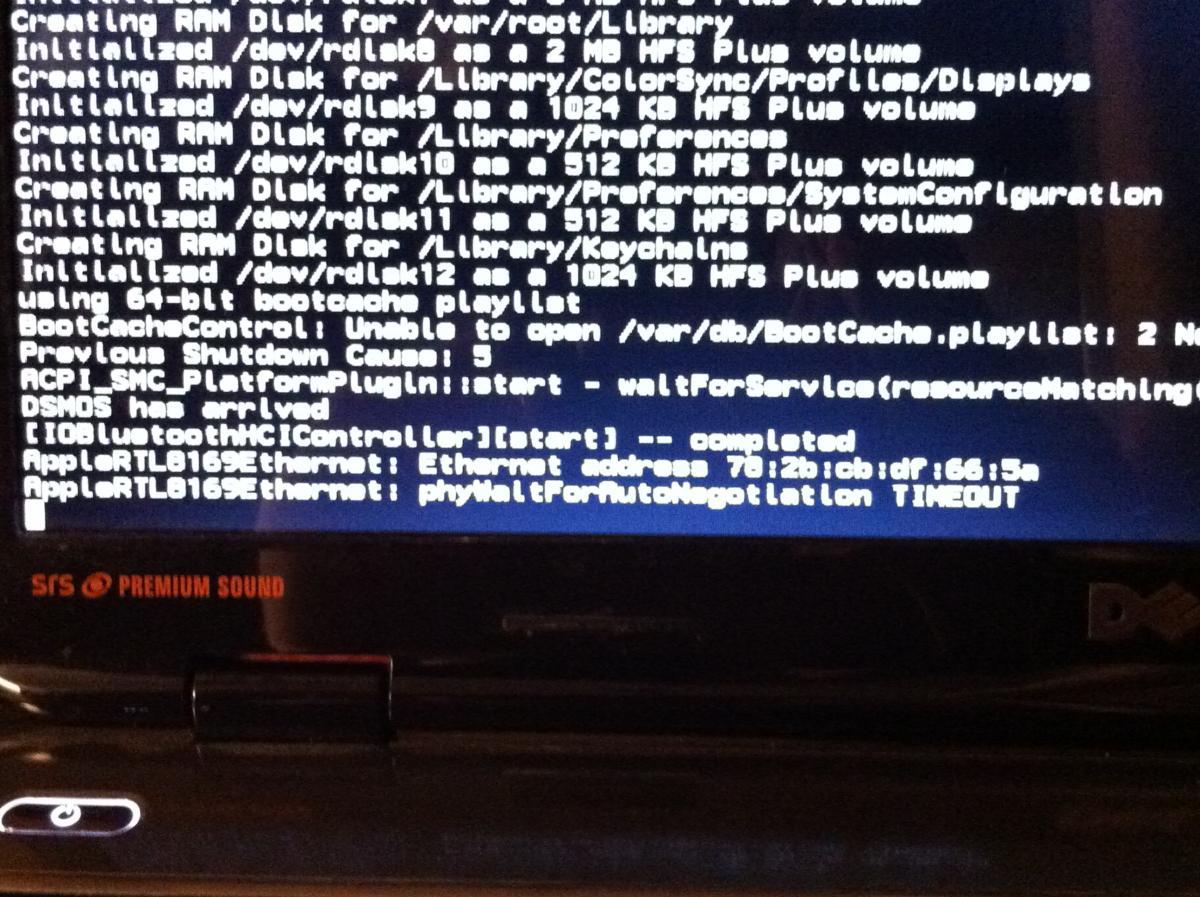

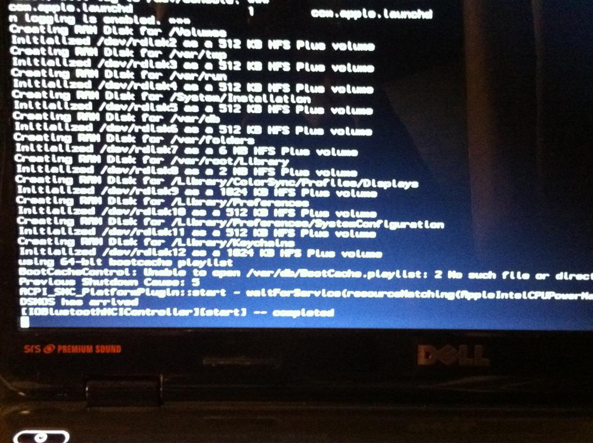

I am trying to install mountain lion on my Dell N5010 but keep getting a kernal panic on the ethernet before evenbeing able to install OSX.

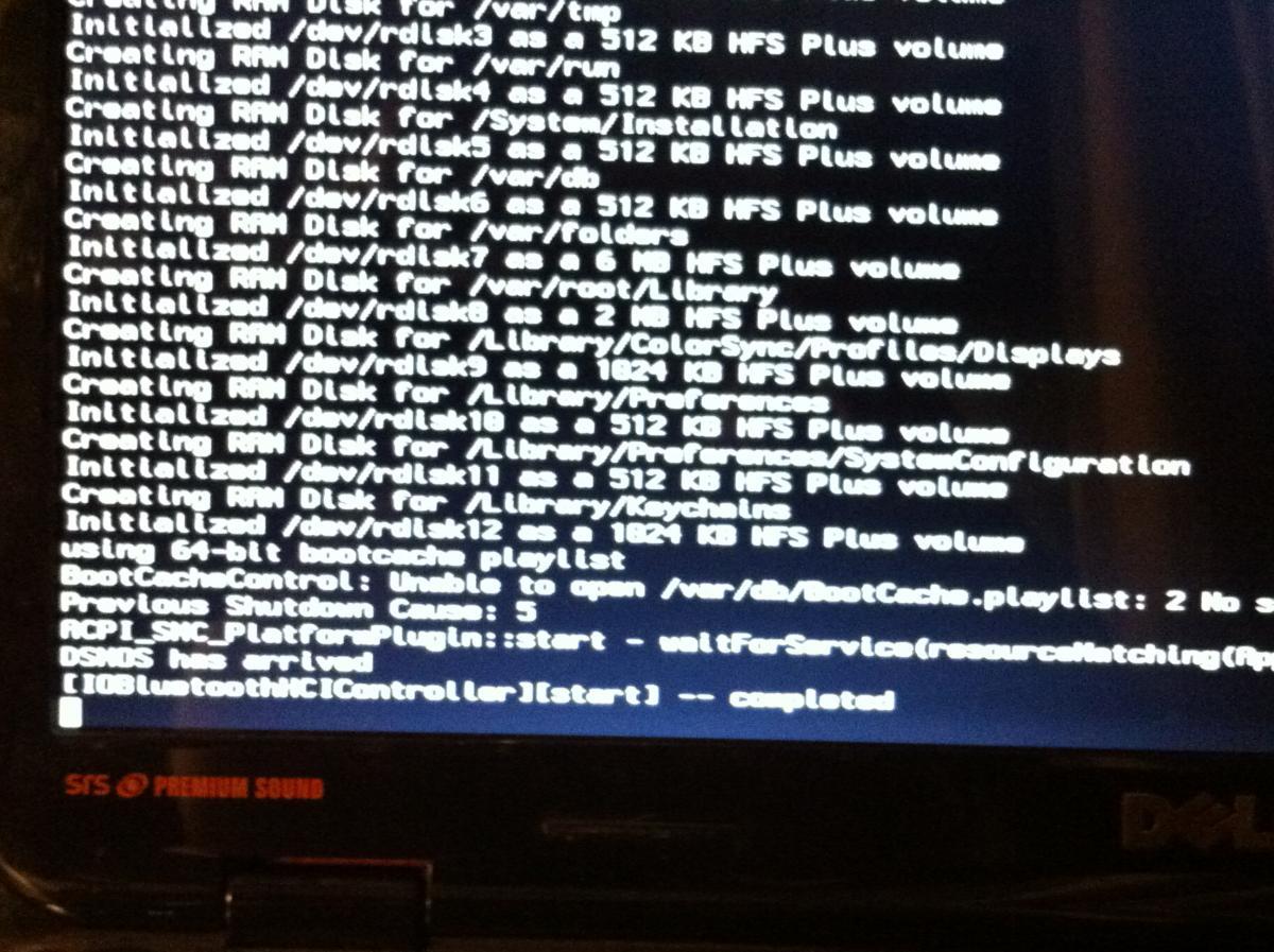

Are you sure it kp or just hanging after displaying Ethernet? If the later, it means it's not able to load the display driver. If it has the Intel built-in display, it's probably the 1st generation gma display and getting QE/CI on it is hit and miss.
So, please list your full specs here. Perhaps it might have different video.

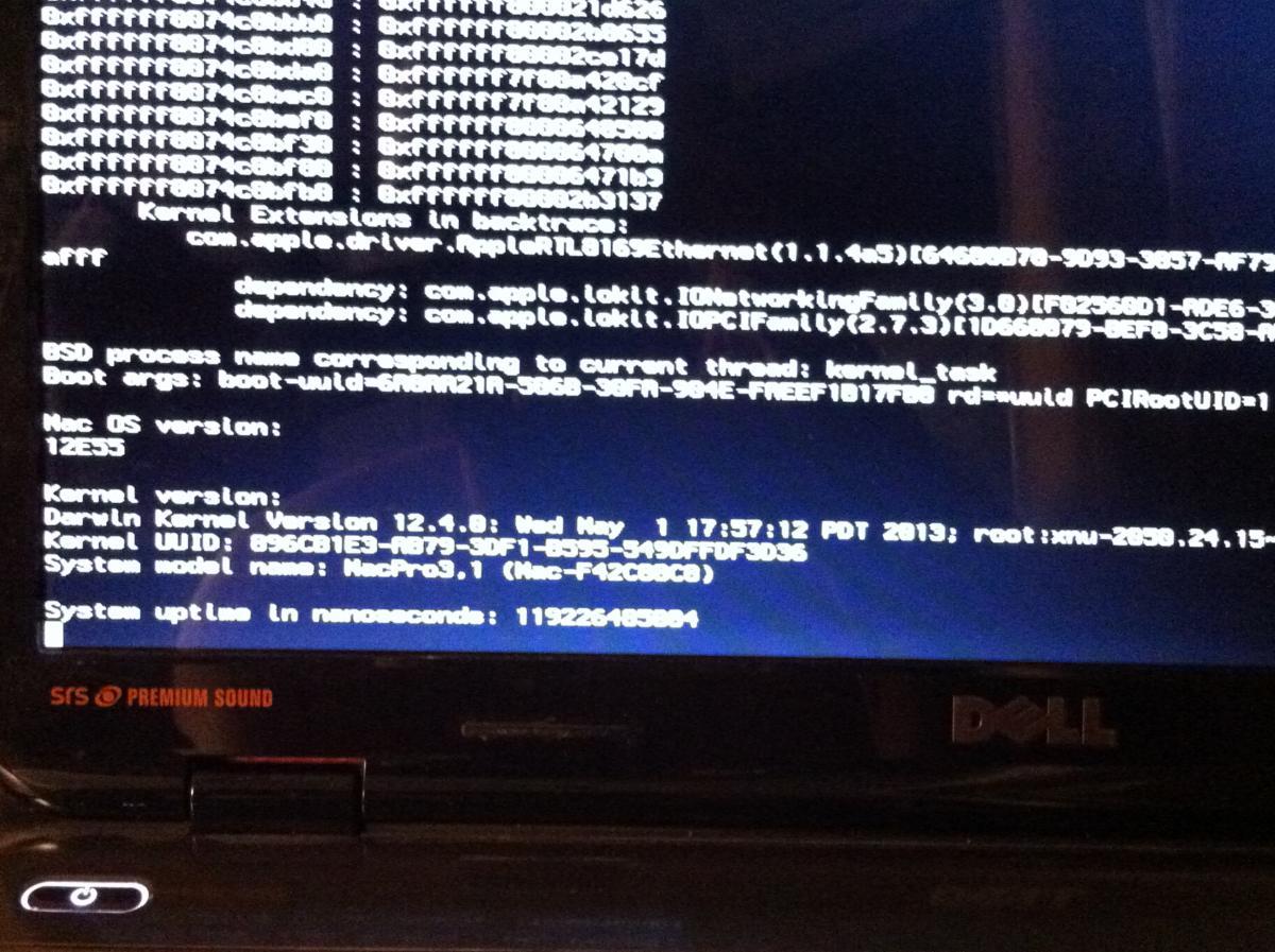

Above Below are the screenshots of what i am seeing when i get the KP

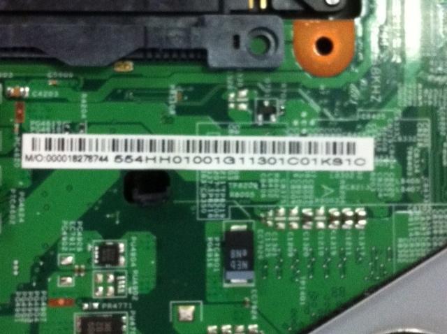

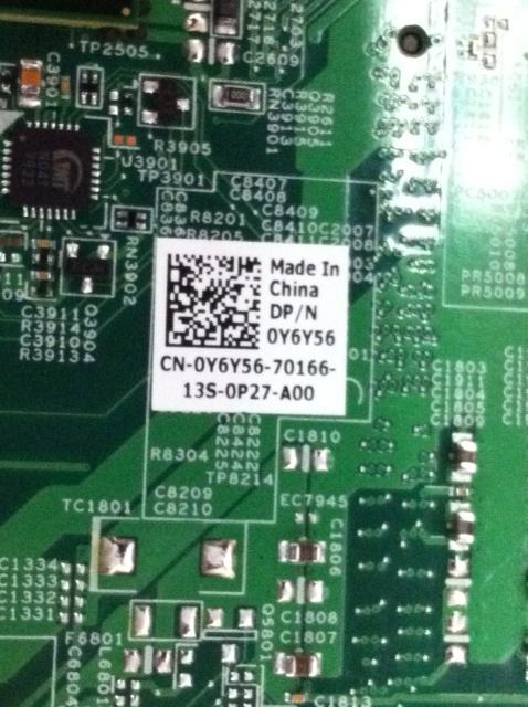

I have also attached the picture of the wifi board label and labels on the mother board
