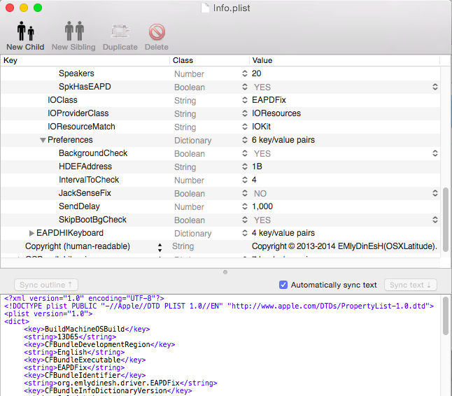

CodecCommander does everything as it should. The status reported is also correct, but something is wrong in the configuration. Can you double check that path for Output exists ??? I don't see jack inerstion being simulated in your log.
is it that you want it?

i successed eapd. i dealed with pinconfig. good working. but sometimes if plug hp, after sleep, can listen music, but unplug hp, i cant listen music through spk and hp
Ha, actually with the patch in place popping the bezel to get jack sense working is not required!
Which confirms it's not the problem with either the controller or codec (internal connections) itself, but with the way AppleHDA treats power state switching for Intel chipset HDA controller. This jack sense loss issue doesn't exist on MCP chipset. This definitely needs to be looked into ..
i tested to try again.
but i'm losted to jack sensor
I told you it was a problem with your pinconfig and not the kext itself.
To see if jack sense problem would be gone try the following patch with clover (valid for 10.9.4 and 10.9.5):
Also, try disabling Generate Stream and set Simulate Headphones to 0. You should see fully working sound before and after with no extra notifications and additional EAPD updates with 30 second delays .. I'm working towards finding a universal solution to this problem, but being alone on this kind of sucks..
i fixed it with no extra notification and additional EAPD updates with 30 second delays :), and tested in lion 10.7.5, yosemite 10.10 dp5
