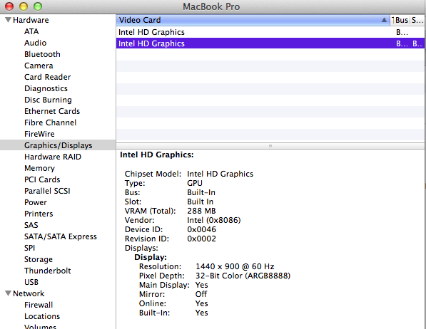

Well, according to Leon, his X201s is quite different from "regular" X201: different screen res (he's got the WSXGA+ 1440x900 LCD) and probably different kext like framebuffer... So, you're not out of muddy waters yet I'm afraid.
