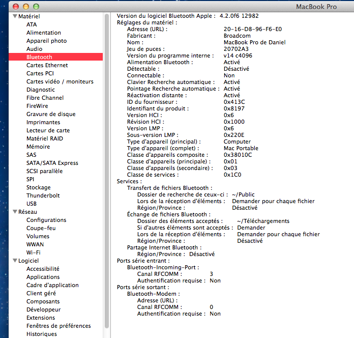

girardpallet Posted February 16, 2014 Share Posted February 16, 2014 On 2/15/2014 at 11:21 PM, girardpallet said: no luck, still same trouble ! i will try now to rebuild the cache with kext Wizard, if not ok, i will continue tomorow. thank for support Bluetooth is now enable , BUT impossible to connect something . the bluetooth is not able to discover the mouse or the phone ! need some more help. attache a print screen of the system info 1 Link to comment Share on other sites More sharing options...
Administrators Hervé Posted February 19, 2014 Administrators Share Posted February 19, 2014 That probably means the radio is turned off in ROM, in which case you could find yourself having to activate BT from Windows as described here: https://osxlatitude.com/index.php?/topic/1824-bluetooth-adapters-latitude-d-series-inspiron-laptops/ Link to comment Share on other sites More sharing options...
