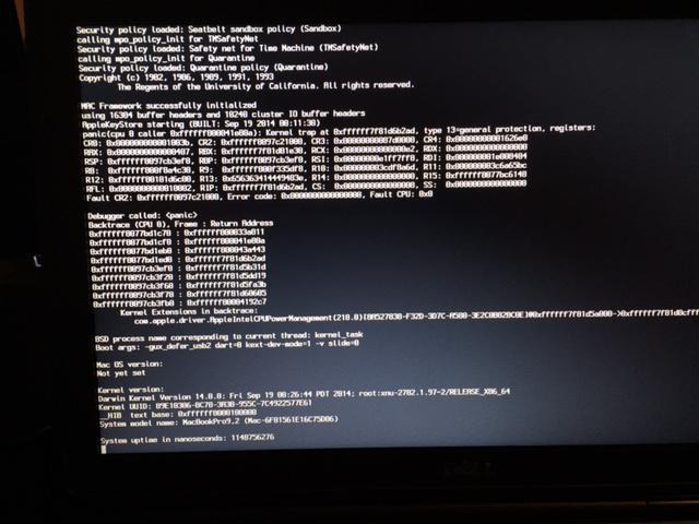

bsmile000 Posted January 18, 2015 Share Posted January 18, 2015 And when I start with verbose on, I get the messages as attached in the screenshot. Link to comment Share on other sites More sharing options...
Administrators Bronxteck Posted January 18, 2015 Administrators Share Posted January 18, 2015 add boot flag -xcpm and you might also need ASUS AICPUPM fix in clover config. Link to comment Share on other sites More sharing options...
