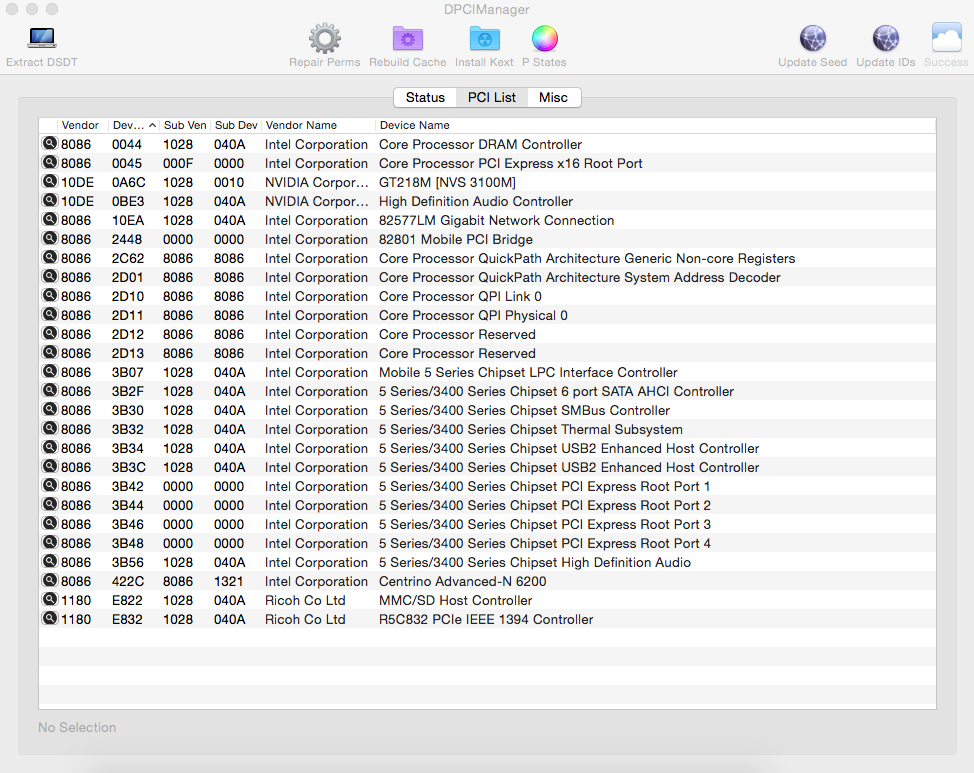

Celestialdeath99 Posted May 30, 2015 Author Share Posted May 30, 2015 I do not see my wifi device in this list: Link to comment Share on other sites More sharing options...
Moderators Jake Lo Posted May 30, 2015 Moderators Share Posted May 30, 2015 That would explain why it's not working. Check to see if the wireless switch on the side is set to 'On' Check the BIOS to see if it's enabled and detected. If all fails, check to see if it's seated properly. Link to comment Share on other sites More sharing options...
Administrators Bronxteck Posted May 31, 2015 Administrators Share Posted May 31, 2015 isn't centrino advanced-n 6300 your wireless? intel wireless is not supported in OS X Link to comment Share on other sites More sharing options...
Moderators Jake Lo Posted May 31, 2015 Moderators Share Posted May 31, 2015 Good call Bronxteck. Was busy looking for DW1510 and didn't bother looking at the Intel. However there is a second slot for WWAN he could place the card... Link to comment Share on other sites More sharing options...
Celestialdeath99 Posted June 1, 2015 Author Share Posted June 1, 2015 Yes, I relized after I sent the picture that this laptop had an Intel wireless chip. Must have been an custom change by the person I got it from. I added a different chip into the WWAN slot and it works without anything extra. Link to comment Share on other sites More sharing options...
