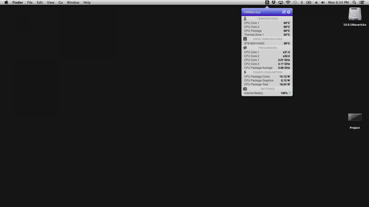

ssprod Posted February 8, 2016 Author Share Posted February 8, 2016 Thanks Bronx.. What do you think of these readings?ssprod Link to comment Share on other sites More sharing options...
Administrators Hervé Posted February 8, 2016 Administrators Share Posted February 8, 2016 All perfectly normal. Link to comment Share on other sites More sharing options...
