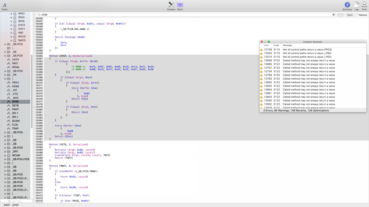

Administrators Hervé Posted March 24, 2016 Administrators Share Posted March 24, 2016 You're trying to add a SDXC device when your DSDT already has a PXSX device under RP08 (assuming that's where you've located your SD card reader). That's wrong. Then, you're missing the DTGP method, so you need to add that too. Anyway, can't really do anything without your IOReg to verify things! Link to comment Share on other sites More sharing options...

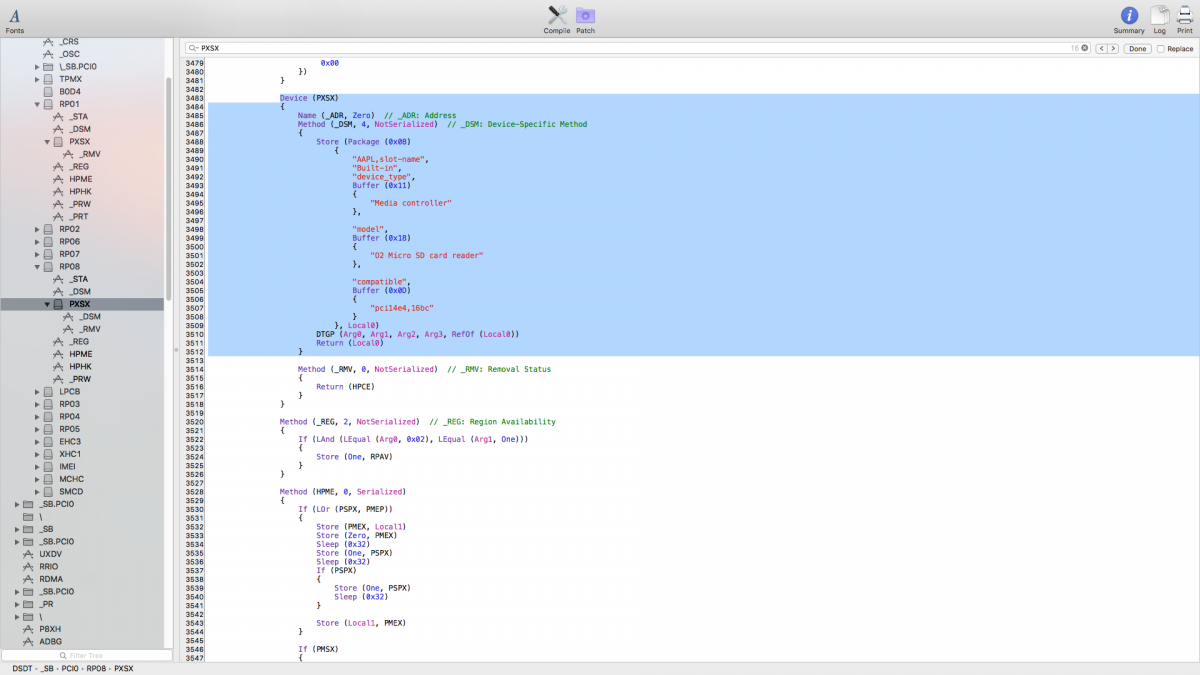

mariano Posted March 25, 2016 Author Share Posted March 25, 2016 ok, I added the DGTP code and I modified the PXSX. I include photos and dsdt.aml patched and IOREG. The card reader is still not recognized, but I have no errors in dsdt.aml Where am I wrong? thank you. IOREG_sdcard.zip DSDT_patched.aml.zip Link to comment Share on other sites More sharing options...

Administrators Hervé Posted March 25, 2016 Administrators Share Posted March 25, 2016 Please try and understand what you're doing. Why would you patch the VoodooSDHC kext with Broadcom card reader id 14e4:16b when that device is natively supported by OS X? You only patch the VoodooSDHC kext with your own card reader id (i.e. 10ec:5227 ), nothing else. 1) You patch the VoodooSDHC with your own hardware id so that you try to get the card reader working through that kext /driver or (and only OR, not AND) 2) you patch your DSDT to declare your own card reader compatible with OS X natively supported/default model; the idea is that OS X then loads its native SDXC kext/driver to handle your own hardware. Bottom line is that you must not mix the VoodooSHDC kext + DSDT patch for native SD card reader recognition. You use one OR the other. Bear in mind that there's no guarantee at all that this will work. SD card readers are like webcams: some work, some just don't. Link to comment Share on other sites More sharing options...
