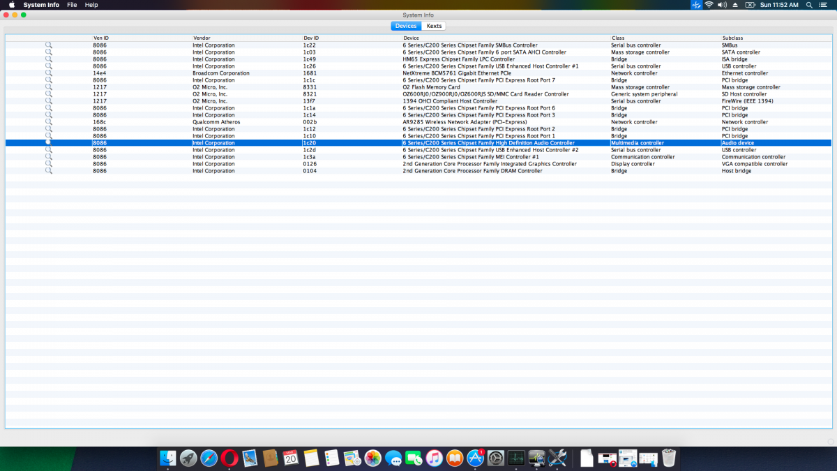

I am using a hdmi cable to test ,
so that the audio is not working
Model Notebook : dell e5520 hd 3000 i7 8 gb 500 gb
Audio information :
Ven ID : 8086
Dev ID : 1c20
Device : 6 Series / C200 Series Chipset Family Hight Audio Definition

So you're not getting audio?
​I'm not seeing your second tab.
