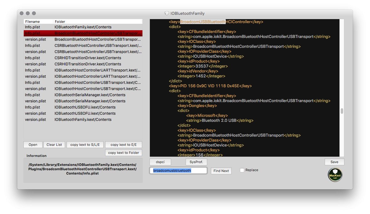

Moderators Jake Lo Posted April 5, 2016 Moderators Share Posted April 5, 2016 Replace Config with this. I added the correct audio patches. Also remove AppleHDAIDT, that's for 92HD90bxx, install instead AppleHDA_IDT for Exx30 (92HD93) from the same link above. For Bluetooth, you'll need to add you Ven/Dev ID to /System/Library/Extensions/IOBluetoothFamily.kext/Contents/PlugIns/BroadcomBluetoothHostControllerUSBTransport.kext/Contents/Info.plist Use macKextlight, drag IOBluetoothFamily.kext to the Window on the left Do a search for BroadcomUSBBluetooth Paste this between and with the Prod/Ven ID of your device Broadcom380FamilyUSBBluetoothHCIController CFBundleIdentifier com.apple.iokit.BroadcomBluetoothHostControllerUSBTransport IOClass BroadcomBluetoothHostControllerUSBTransport IOProviderClass IOUSBHostDevice idProduct 33175 idVendor 16700 Click save and repair permission. config.plist.zipFetching info... Link to comment Share on other sites More sharing options...
savage24x Posted April 6, 2016 Author Share Posted April 6, 2016 Everything is working, except bluetooth. First thing I did was the patch with macKextLight, then rebooted. Bluetooth worked. Then, I replaced the config.plist with the one you created for me. I lost bluetooth. HDA_IDT works great. Everything is working except bluetooth. I attached my CLOVER folder. That folder contains your config.plist with the patches. I have also attached my working config.plist that bluetooth works with. Only difference is the patches. Ever since I ran: sudo pmset hibernatemode 0 sudo rm -f /var/vm/sleepimage sudo pmset hibernatefile /dev/null I have not been able to wake my laptop from sleep. Just a black screen with a spinning color wheel. CLOVER_savage24x.zipFetching info... config.plist.zipFetching info... Link to comment Share on other sites More sharing options...
