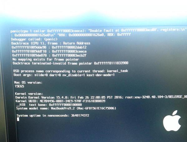

bnichols024 Posted April 14, 2016 Author Share Posted April 14, 2016 Still no go. BIOS all the way up to date. AsusAICPUPM is checked. Not sure where to go from here. Link to comment Share on other sites More sharing options...
Administrators Hervé Posted April 14, 2016 Administrators Share Posted April 14, 2016 What happens when you boot without cache and in verbose mode? Link to comment Share on other sites More sharing options...
Moderators Jake Lo Posted April 14, 2016 Moderators Share Posted April 14, 2016 Even for the E6430s, you'll need to restore BIOS to A11 as per the E6430/E6230, otherwise you'll encounter artifacts. Before getting that fix, let's see if you could get it to install first. You mentioned using the E6430 bootpack which has high resolution set to 1600x900. If you have 1366x768, make sure to replace bootpack with E6230 instead. Link to comment Share on other sites More sharing options...
bnichols024 Posted April 14, 2016 Author Share Posted April 14, 2016 Beautiful. Changing to the E6230 bootpack seemed to do the trick. El Capitan is currently installing. The display had some artifacts for a short period of time but like you said, restoring to A11 should resolve that. Link to comment Share on other sites More sharing options...
Administrators Hervé Posted April 14, 2016 Administrators Share Posted April 14, 2016 So it was the DualLink DSDT parameter set to 1 that caused your issue. It's set to 0 for screen res up to 1440x900, to 1 for anything above such as 1600x900 or higher. Link to comment Share on other sites More sharing options...
Moderators Jake Lo Posted April 14, 2016 Moderators Share Posted April 14, 2016 ig-platform-id is also set to 0x01660004 for dualLink and 0x01660003 for single in DSDT too and also in the Config.plist. Link to comment Share on other sites More sharing options...
