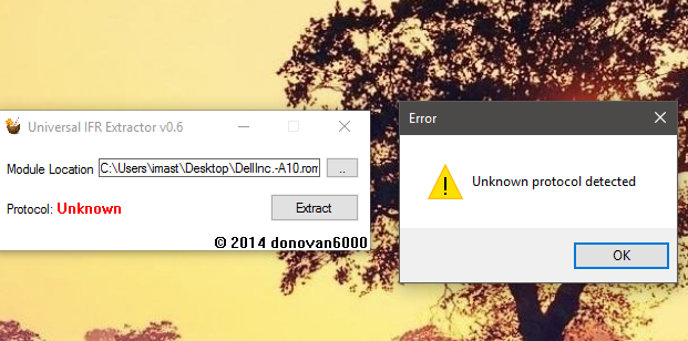

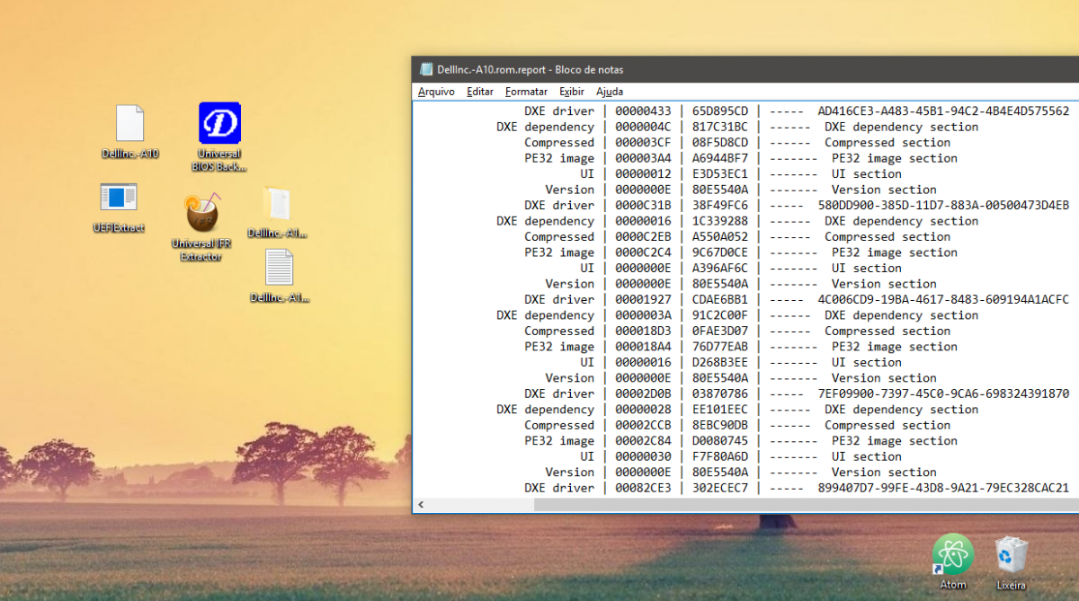

I opened the Dell.Inc-A10 file using UEFI Extract, generated a folder and a txt file that I do now, I do not know how to generate the file setup.bin
Share this post
Link to post
So DellInc.-A10.rom is the version of your BIOS? Make sure it's not for a different system. My guide is use as an example only.
Ok, once you exported the rom file, open the file with UEFITool.exe, not Universal IFR Extractor.
Search for Setup. Once you find that, extract PE32 image section(setup.bin).
Open the bin with with the Universal IFR Extractor to convert to a txt file
Open the txt file with notepad and search for DVMT.
This will lead you to the location of the value.

I got here but hair que vi File THIS All right ,
only the HD that is not showing up at installation time .
I got here but hair que vi File THIS All right , only the HD that is not showing up at installation time .
