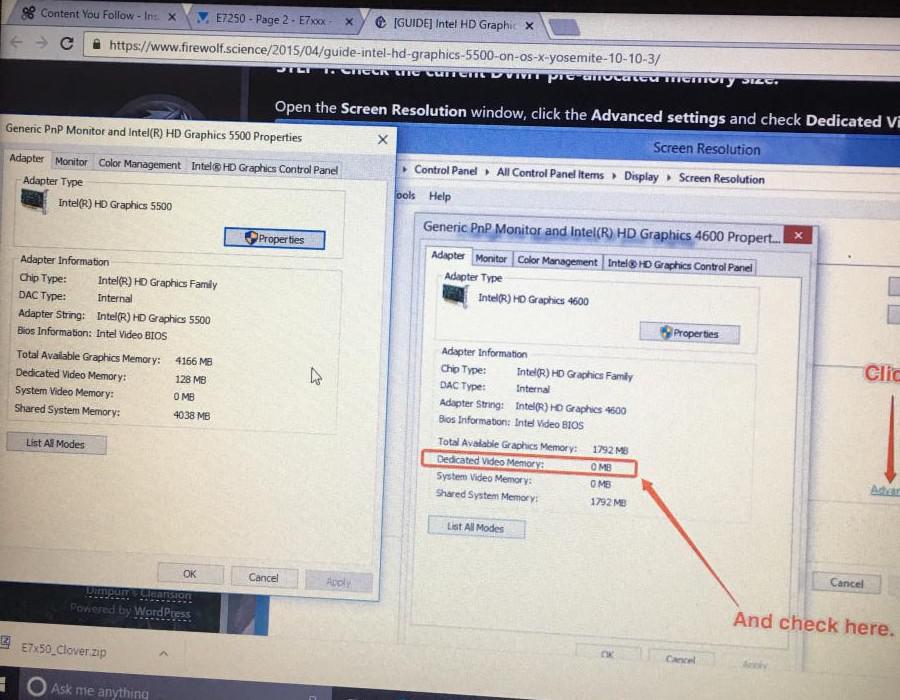

Trunyce Posted November 2, 2016 Author Share Posted November 2, 2016 Thanks Jake Lo, I came across the other 16 page topic on the E7250 last night to its entirety and saw dstrukt post on how you helped him out with his.. His model is the same as mine. I tried his DSDT along with his config.plist and render my machine unbootable. I keep getting the early reboot when i try to boot in verbose and can't see exactly what's causing it. I don't want to have to reinstall, so my plan is to remove the msata and connect it to a msata to 2.5 sata enclosure and connect it to my other hackintosh to access the EFI partition and remove his DSDT and config.plist. I hope that will help. I thought i had to do the DVMT mod but i don't in the end because my machine is showing this in windows: Not working are: Wifi, sound, screen brightness. Link to comment Share on other sites More sharing options...
Moderators Jake Lo Posted November 2, 2016 Moderators Share Posted November 2, 2016 your early reboot will be due to KP of the graphics card. You'll need to set the DVMT to 96mb even though windows show you have enough. 1 Link to comment Share on other sites More sharing options...

Trunyce Posted November 3, 2016 Author Share Posted November 3, 2016 your early reboot will be due to KP of the graphics card. You'll need to set the DVMT to 96mb even though windows show you have enough. Could you guide me to the appropriate guide for the E7250 DVMT mod? I will do it tonight. Link to comment Share on other sites More sharing options...
Moderators Jake Lo Posted November 3, 2016 Moderators Share Posted November 3, 2016 Here under Prerequisite. The values are already determined, just need to create the USB with EFI shell and run the 2 commands. setup_var 0x15b 0x3 setup_var 0x15c 0x3 Link to comment Share on other sites More sharing options...
