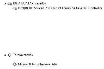

kushwavez Posted August 8, 2017 Author Share Posted August 8, 2017 I checked on Windows, there is Intel 100 series/c230 sata ahci controller. is that? and 1TB SATA HDD Link to comment Share on other sites More sharing options...
Moderators Jake Lo Posted August 8, 2017 Moderators Share Posted August 8, 2017 You could check either BIOS or Windows. In Windows, go to device manager, under Storage Controllers, you should see Standard NVM Express Controller if you have an NVMe SSD. If you do, right click it and select properties, then details tab. Under Property, select BIOS device name. Note down the value of the BIOS device name and post it here. Link to comment Share on other sites More sharing options...
kushwavez Posted August 8, 2017 Author Share Posted August 8, 2017 there are no nvme controller so seems I don't have NVMe SSD. I have SATA but not SSD, just HDD Link to comment Share on other sites More sharing options...

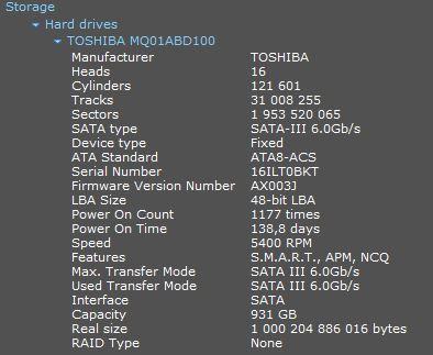

kushwavez Posted August 8, 2017 Author Share Posted August 8, 2017 Here I attach some information about my HDD and device manager. BIOS does not show anything. doesn't have AHCI-SATA function to enable/disable. Link to comment Share on other sites More sharing options...

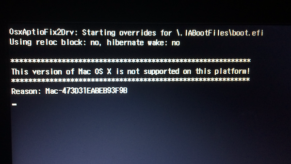

Moderators Jake Lo Posted August 8, 2017 Moderators Share Posted August 8, 2017 Are you booting with -no_compat_check arg? Boot without it. Link to comment Share on other sites More sharing options...
kushwavez Posted August 8, 2017 Author Share Posted August 8, 2017 I got this. Maybe wrong smbios. Link to comment Share on other sites More sharing options...
Moderators Jake Lo Posted August 8, 2017 Moderators Share Posted August 8, 2017 Not sure why, smbios is for Skylake CPU. Try switching smbios to MBP13,3. If still failed, but MBP11,5 Link to comment Share on other sites More sharing options...

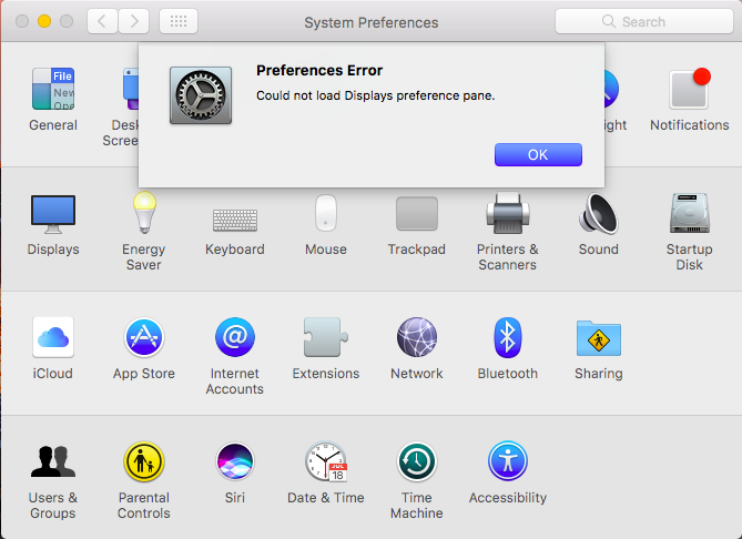

kushwavez Posted August 9, 2017 Author Share Posted August 9, 2017 hmm..weird. with 13,3 it's failed, but with 11,5 finally booted and gained access to install Mac on the external drive. Even no HDD internal in disk util. I installed Sierrra to the external, working: Bluetooth(Tested), Graphics, Audio(ALC255,fixed with kext), Battery info(fixed with kext) . Not working: WiFi(replaced), Ethernet, Light Control, Internal drive. Actually I can't get into Display settings (on the pic). Link to comment Share on other sites More sharing options...
