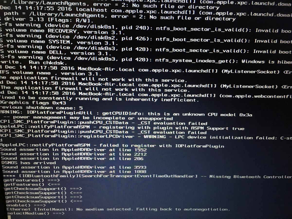

wonder2 Posted December 14, 2016 Share Posted December 14, 2016 Latitude 6430u, i7-3687U BIOS A4, AHCI, UEFI Intel HD 4000 (1366x768) Hi guys, I am following instructions from Dell Latitude/Inspiron/Precision - El Capitan Clover Guide. I used bootpack for E6230, Clover boots, after I press Install OS X, the progress bar reaches about 50% and then I get black screen. What can I do next? Any help is really appreciated. Thank you, Link to comment Share on other sites More sharing options...

Administrators Hervé Posted December 15, 2016 Administrators Share Posted December 15, 2016 Boot in verbose mode to se when it hangs. Link to comment Share on other sites More sharing options...
wonder2 Posted December 15, 2016 Author Share Posted December 15, 2016 Here you go Let me know if you need more Thank you, Link to comment Share on other sites More sharing options...
Administrators Hervé Posted December 15, 2016 Administrators Share Posted December 15, 2016 Seems your graphics are not initialising. You seem to run a really old BIOS version on that 6430u. I'd invite you to update but remember that you may not be able to run past a given version like on the E6x30 Series. Try out latest version A11 anyway. Bear in mind that the Latitude 6430u is not an 'E' model even though it's close in terms of specs (it's specifically based on ULV CPUs). As such, I'm not 100% certain that you can re-use the DSDT of the E6x30 series. Have a look at the existing threads related to the Latitude 6430u in this very section. Refer to this old Mavericks guide for reference (especially DSDT): https://osxlatitude.com/index.php?/topic/7133-dell-latitude-6430u-with-i7-3667u-hd-4000-mavericks-1094/?hl=6430u Link to comment Share on other sites More sharing options...
