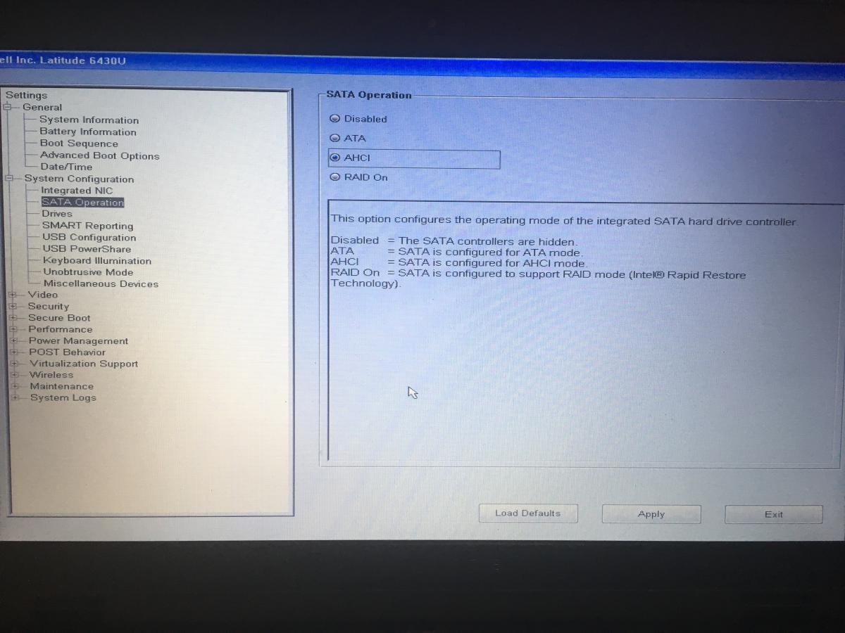

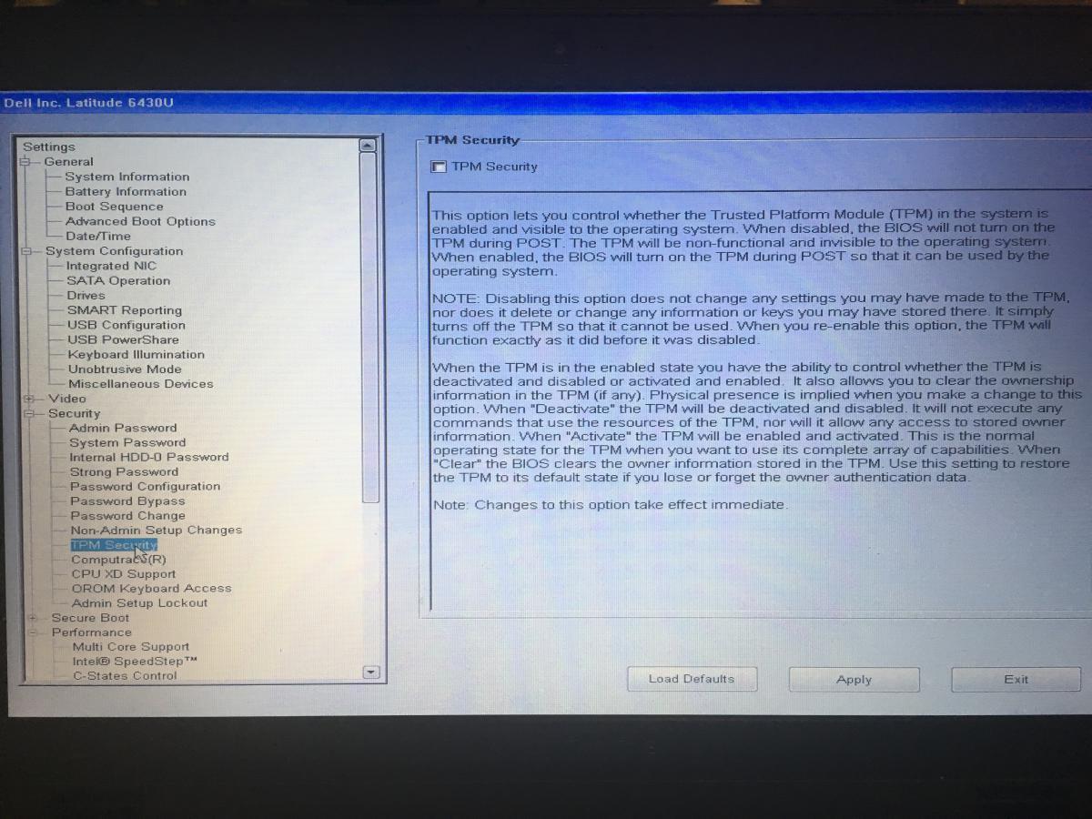

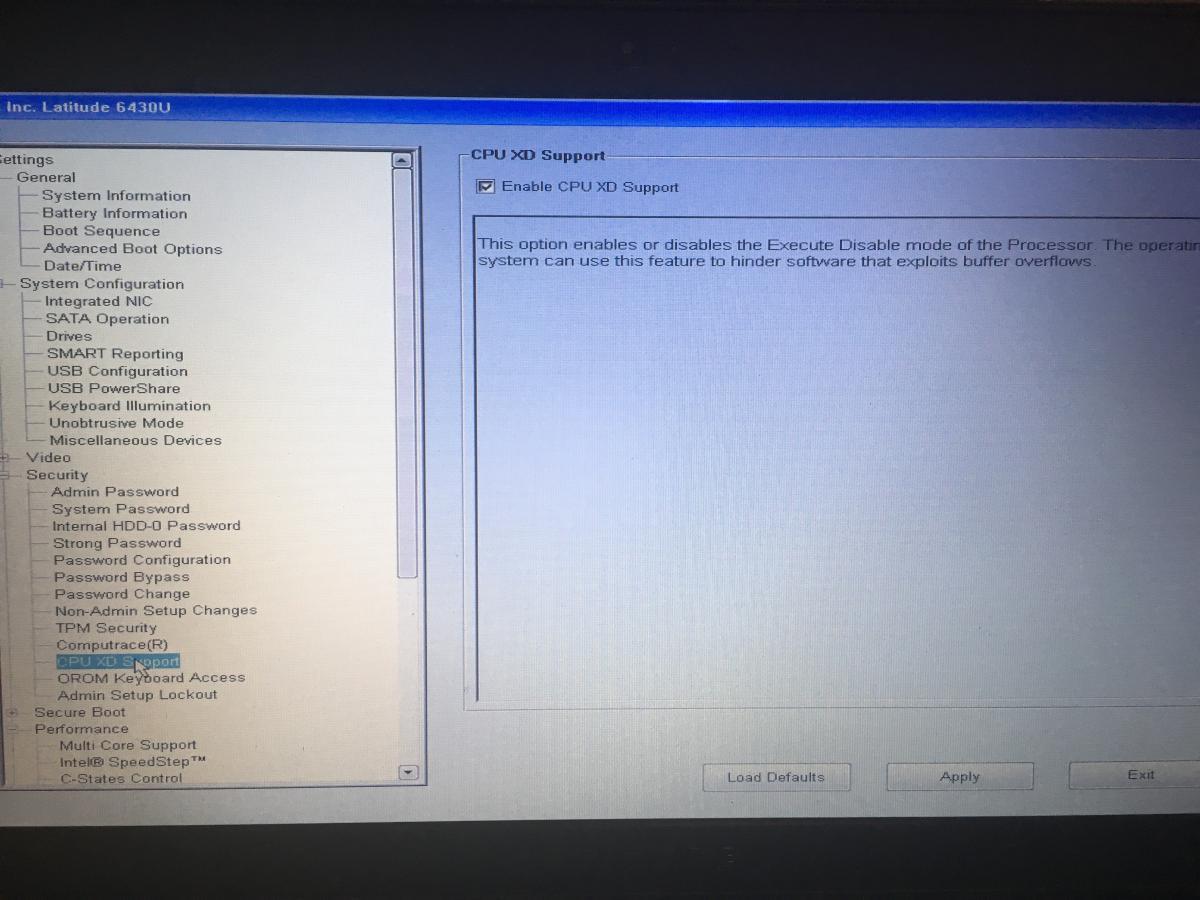

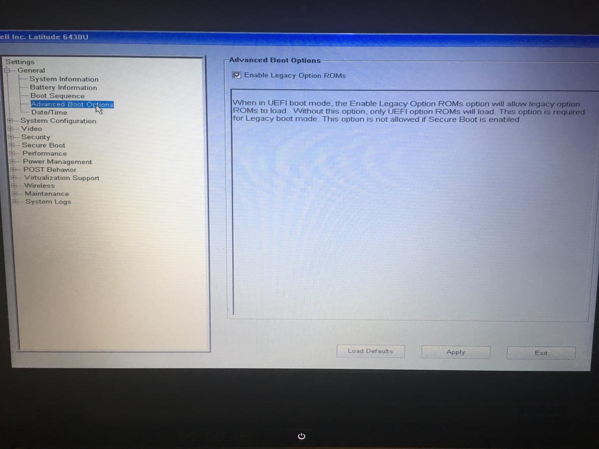

Moderators Jake Lo Posted December 19, 2016 Moderators Share Posted December 19, 2016 Your EFI folder looks fine. Let's try going into the BIOS, click on 'Load Defaults', hit Apply. Now set the following settings: Enable UEFI Enable Legacy Option Rom SATA Operations to AHCI Check also that CPU XD - Enabled Secure Boot - Disabled Disable TPM (uncheck) Link to comment Share on other sites More sharing options...

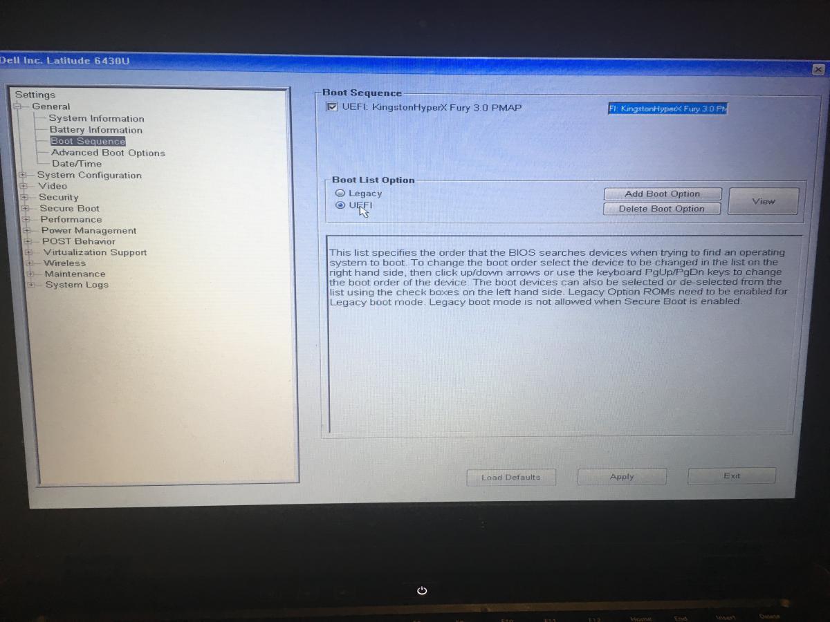

Administrators Bronxteck Posted December 21, 2016 Administrators Share Posted December 21, 2016 did you add the clover path into entry here https://osxlatitude.com/uploads/monthly_12_2016/post-102564-0-57835300-1482294305.jpg and set it as boot. Link to comment Share on other sites More sharing options...
wonder2 Posted December 21, 2016 Author Share Posted December 21, 2016 BIOS does not allow me to change the path. I press F12 and select "Boot from USB" and clover boots. Link to comment Share on other sites More sharing options...
Moderators Jake Lo Posted December 21, 2016 Moderators Share Posted December 21, 2016 You select Add Boot Option. Then point it to /EFI/EFI/Clover/Cloverx64.efi. And put a name you want like Clover or OS X. Hit Ok and move the selection to the top. Link to comment Share on other sites More sharing options...
wonder2 Posted December 22, 2016 Author Share Posted December 22, 2016 did that, no difference Link to comment Share on other sites More sharing options...
