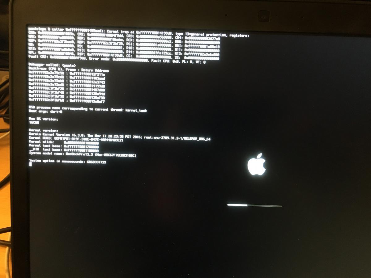

mdub Posted January 13, 2017 Author Share Posted January 13, 2017 What I think I want is running at 2.7ghz constantly. I produce music with Ableton live and performance in large sessions with lots of vst plugins suffers due to the latency introduced with intel speedstep. I basically just want high performance mode all the time, I don't care about battery life, fan noise or heat (as long as I don't melt my CPU lol). I plan to switch between this mode and regular CPU power management when producing and doing basic stuff (surfing web etc).Would nullcpupowermanagement.kext accomplish this? Also I managed to install sierra with this laptop and have everything working except audio, external video and CPU power management. When I generate a SSDT with SSDTprgen I get a kernel panic when using MacBook Pro 13,2 smbios. Using a generated SSDT with iMac 17,1 works fine though. Any ideas what could cause this? See screenshot, thanks Link to comment Share on other sites More sharing options...

mdub Posted January 14, 2017 Author Share Posted January 14, 2017 Yeah I gave up on SSDTprgen and used HWPEnabler. Let's me use MacBook Pro 13,2 SMBIOS, Does what I want it to do and is flexible. Geek bench performance for single core was good at 3501 but kinda low on multi core at 12051. Based on intel power gadget speeds are between 3-3.2ghz when using the correct speed limits for 6820hq CPU. Might have to tinker with it some more and hopefully performance improves with sierra updates. Battery life isn't great on lowest CPU profile with CPU running at .9ghz, only about 3 hours for a full charge. I was getting 4.5hrs prior to loading patched DSDT/SSDT. I'm wondering if GPU PM is enabled, Renaming GFX0 to IGPU for all SSDT/DSDT is all that's required for GPU power management to work on an intel 530 right? AppleIntelInfo displays P states for the GPU but again geekbench scores were low for my model... Link to comment Share on other sites More sharing options...

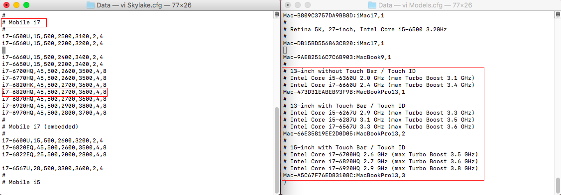

Administrators Hervé Posted January 14, 2017 Administrators Share Posted January 14, 2017 You said you didn't care about battery life... In principle, if Apple followed their past trend, yes it's highly likely that they used IGPU naming convention on the MacBookPro13,1/13,2/13,3. The only way to verify is to obtain an extracted DSDT or IOReg off one of those Skylake MBP. I would certainly run Sierra for such an SMBIOS, that's what those MBP models were released with so I'm not entirely surprised El Capitan would not boot such a profile. If you look at the MacBookPro13,x range, you will see that: MBP13,1: low voltage Skylake i5/i7 CPU + Intel HD 540 graphics (0.30-1.00/1.05GHz) MBP13,2: low voltage Skylake i5/i7 CPUs + Intel HD 550 graphics (0.30-1.05/1.10GHz) MBP13,3: regular Skylake i7 CPUs + Intel HD 530 graphics only (0.35-1.05GHz) or dual Intel HD 530/AMD Radeon Pro 450/455 Re: CPU power management, did you use Pike's Master or Beta branch? You need to use the Beta version for Skylake CPUs. It does cater for i7-6820HQ and MBP13,x as shown in the Skylake.cfg and Models.cfg database files: Link to comment Share on other sites More sharing options...
mdub Posted January 14, 2017 Author Share Posted January 14, 2017 Ideally I'd like to switch off between a high performance mode when producing music in ableton live (where battery life isn't a concern) and a low performance mode with good battery life when doing everyday browsing/web stuff. I did use the beta branch of SSDTprgen and still got a KP when booting generated SSDT with MacBook Pro 13,3. Looks like HWPEnable is the only current working way to fine tune performance with this CPU and correct SMBIOS in Sierra- https://github.com/goodwin/HWPEnable Link to comment Share on other sites More sharing options...
