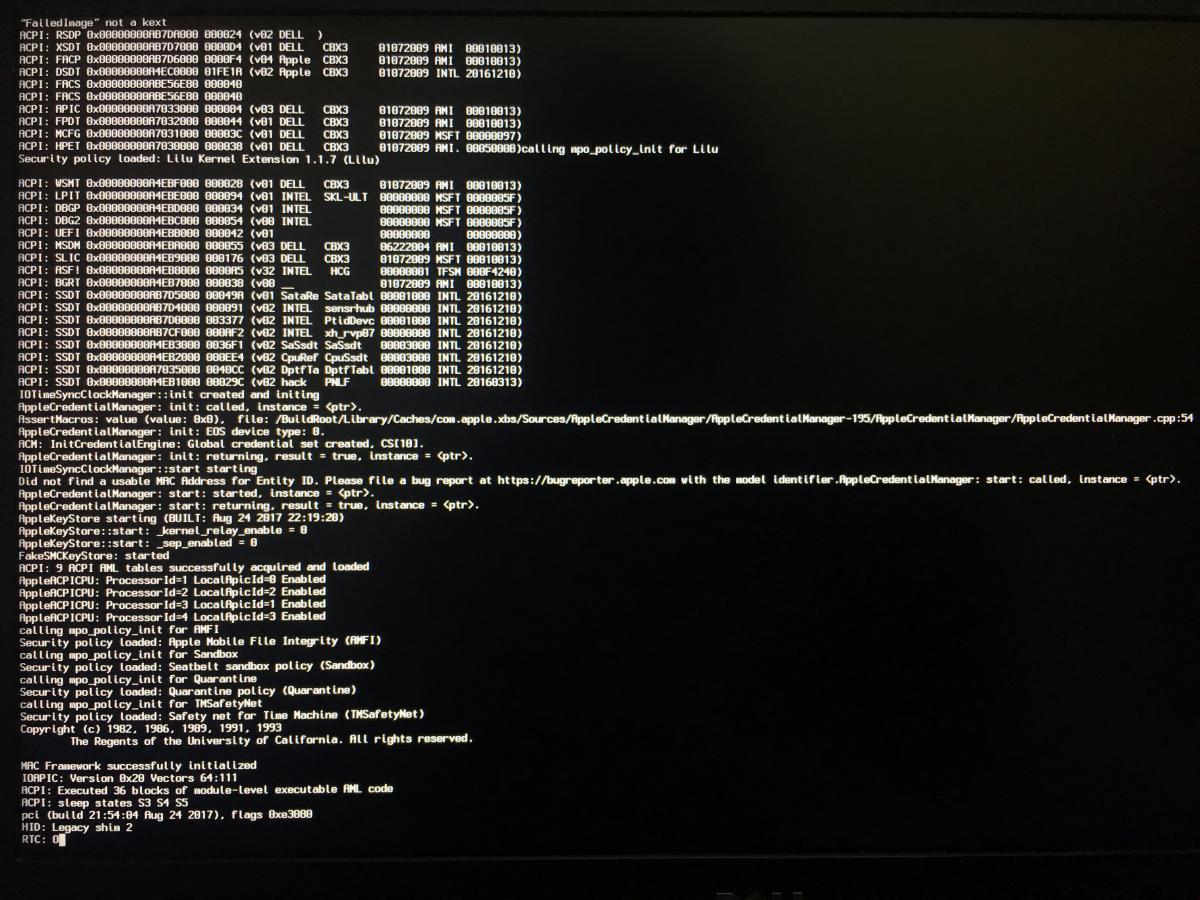

murad3994 Posted October 30, 2017 Share Posted October 30, 2017 Hello everyone! I'm unable to install High Sierra on my E7470. It keep KP before the installation. Following Jake's instructions in below link (Post #3) https://osxlatitude.com/index.php?/topic/10069-dell-latitude-e7440-update-sierra-to-high-sierra/&do=findComment&comment=73121 And used latest bootpack (+configHS) also provided by Jake (Post #3) https://osxlatitude.com/index.php?/topic/9179-dell-latitude-e7x70-clover-uefi-only/&do=findComment&comment=65823 I have encountered these errors in Verbose mode: Kernel Panics Endpoint has been activated through legacy launch please switch to XPC or bootstrap_check_in(): com.apple.xxxxxxxx Warning ACPIBatteryManager changed from 7236 to 7136 Further steps I also took but had no effect: Safe mode, Single User, all available boot options. I tried both E7x70 and E7470_alternate bootpacks Removed RAM from slot B to slot A (This made progress) Removed all kexts except for FakeSMC Tried disabling Integrated NIC + Parallel Port + Serial Port in BIOS Please help. Thanks BIOS version: 1.17.5 (Restored BIOS defaults) AHCI - UEFI - Legacy ROMs enabled - Secure Boot off - TPM disabled config.plist: the one provided for HS by Jake Clover version: v2.4k_r4268 Link to comment Share on other sites More sharing options...

murad3994 Posted October 31, 2017 Author Share Posted October 31, 2017 Hi there Jake, I tried as you asked, but it got stuck. I've also attached Clover with some screenshots. Please note that I don't see the M.2 drive in Clover's boot menu since the beginning. Is this normal? Appreciate your help man. CLOVER.zip Link to comment Share on other sites More sharing options...
Moderators Jake Lo Posted October 31, 2017 Moderators Share Posted October 31, 2017 Your M.2, is it NVMe or Sata SSD? Doesn't matter since HS supports NVMe natively. Reason the drive is not listed is because it only lists bootable drives and your M.2 is not. Not until you have formatted and installed MacOS or Windows. Disable Legacy Option ROMS in the BIOS. Replace the attached file and folders into /EFI/Clover and try again Boot with verbose and debug 0x100 mode murad3994.zip Link to comment Share on other sites More sharing options...
murad3994 Posted October 31, 2017 Author Share Posted October 31, 2017 Now it doesn't show any bootable drives... As for the M.2 drive, it is showing M.2 PCIe SSD-0 in BIOS.. So my guess it's NVMe. Edit: Just to make sure I install Clover correctly, I select the following options: Install for UEFI booting only Install Clover in the ESP Drivers64UEFI > OsxAptioFixDrv-64 Edit 2: Also in Clover boot menu, it has the following options pre-selected: Disable KASLR (slide=0) Set Nvidia to VESA (nv_disable=1) In Boot Args: slide=0 dart=0 nv_disable=1 kext-dev-mode=1 CPU-Z screenshots attached for reference. CPU-Z.zip Link to comment Share on other sites More sharing options...
