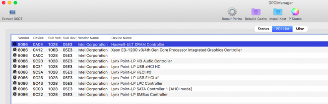

jones333333 Posted November 28, 2017 Author Share Posted November 28, 2017 Jake Lo, thanks a lot for all these infos! hus2020, do you already found a good WIFI/BT card replacement for this model ? I think that our best choice would be the Dell DW1560 as Jake Lo said in an earlier post but these are generally out of stock on the different sites: Link to comment Share on other sites More sharing options...
