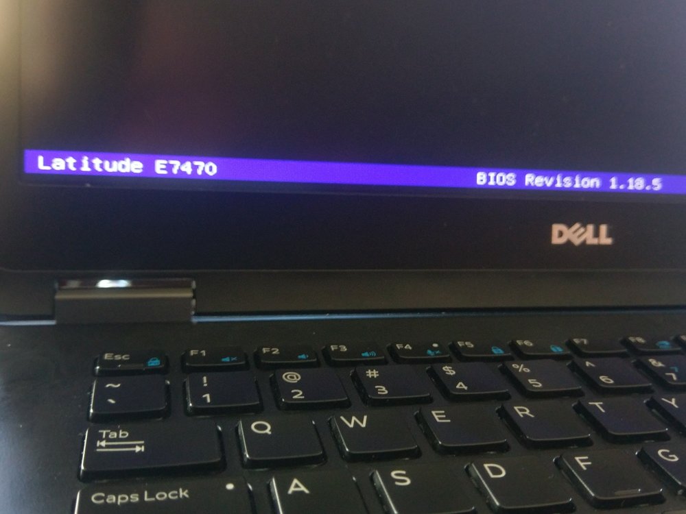

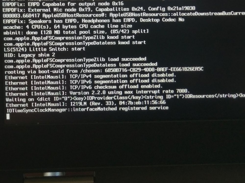

jfrank58 Posted May 26, 2018 Author Share Posted May 26, 2018 Thank you for your responses. I have "fix headers" selected, and have tried replacing "contents" in EFI/Clover as suggested by Jake but still fails to boot. My Bios indicates version 1.18.5. This screen shows where boot stalls Link to comment Share on other sites More sharing options...
Moderators Jake Lo Posted May 26, 2018 Moderators Share Posted May 26, 2018 with the updated files, check for FixHeaders at Clover boot Options and try again. If still fails, then try booting to Clover GUI, hit F4. Now compress and attach the Clover folder here. Will need to patch your personal files for you Link to comment Share on other sites More sharing options...

Moderators Jake Lo Posted May 28, 2018 Moderators Share Posted May 28, 2018 Disable Legacy Option ROMs. That should be enough along with the other settings you had mentioned. Link to comment Share on other sites More sharing options...
