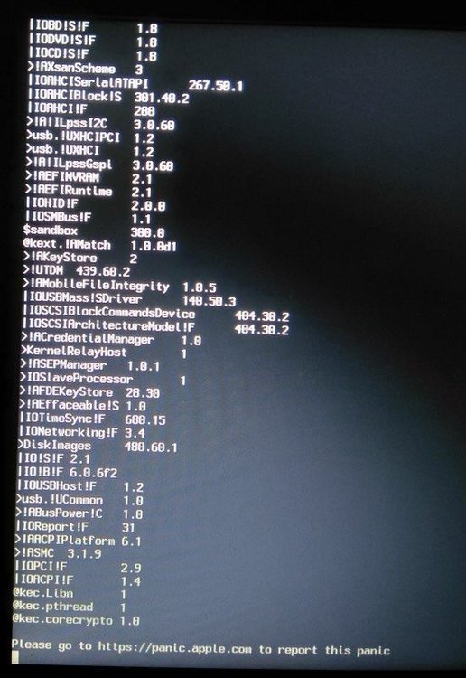

can't install high sierra on Acer Aspire ES-15
1) how to write log?
2) how to start mac os with clover on Acer Aspire ES1-572
i3 6006U
8GB DDR3L
120GB SSD
Notebook reboots after clicking on install button

Looks like you're using patched kext from another system that has Kabylake HD620, yours is Skylake HD520.
Boot with USB installer again.
At the GUI, press F4.
Now press the spacebar. Select verbose and debug 0x100 mode
Post the screenshot of the KP (error)
Compress and attach the Origin folder inside /EFI/Clover/ACPI/
I'll patch the files for you
