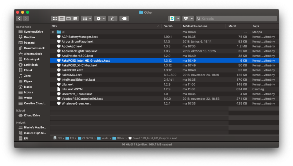

dctacsi Posted December 26, 2018 Share Posted December 26, 2018 Hi! First of all Merry Christmas for everyone !!! Today I upgraded from High Sierra to Mojave. Everything works perfectly, except WiFi. Unfortunately, he doesn't see the device right now. Although I am not using the DW1550 device, but DW1502 (it was in the drawer at home), but I didn't have to do anything else so far to work. I just installed everything according to the descriptions and like, but now I don't see the device. Do you have a hint of what I've done or what I could try? Thank you in advance for your help! Link to comment Share on other sites More sharing options...

Moderators Jake Lo Posted December 26, 2018 Moderators Share Posted December 26, 2018 @dctacsi DW1502 is Atheros based and it's been dropped from Mojave. See here for more info Get rid of AzulPatcher4600.kext, it's now part of Whatevergreen. Link to comment Share on other sites More sharing options...
dctacsi Posted December 27, 2018 Author Share Posted December 27, 2018 Hello, Thank you very much for the help, I downloaded the file "10.13.6_AirPortAtheros40.kext.zip" found on the link. After unpacking, I copied it to the "/Library/Extensions/" folder. I ran the following command in the terminal: sudo chown -R root:wheel /L*/E*; sudo chmod -R 755 /L*/E*; sudo kextcache -i / But nothing has happened, but after the restart the hardware is not visible. In Terminal, I find the following: Last login: Thu Dec 27 04:24:53 on ttys000 Soos-MacBook-Pro:~ blasio$ sudo chown -R root:wheel /L*/E*; sudo chmod -R 755 /L*/E*; sudo kextcache -i / Password: Kext with invalid signatured (-67062) allowed: <OSKext 0x7f8a1cccb230 [0x7fff995c38f0]> { URL = "DisableTurboBoostBattery_2.3.kext/ -- file:///Library/Extensions/", ID = "pk.qwerty12.DisableTurboBoostBattery" } Kext with invalid signatured (-67062) allowed: <OSKext 0x7f8a1ccbf200 [0x7fff995c38f0]> { URL = "CodecCommander.kext/ -- file:///Library/Extensions/", ID = "org.tw.CodecCommander" } KernelCache ID: 08D7BF16361471FD9E3493FBEA795E4C Kext with invalid signatured (-67062) allowed: <OSKext 0x7fc235d06580 [0x7fff995c38f0]> { URL = "CodecCommander.kext/ -- file:///Library/Extensions/", ID = "org.tw.CodecCommander" } Kext with invalid signatured (-67062) allowed: <OSKext 0x7fc237e72230 [0x7fff995c38f0]> { URL = "DisableTurboBoostBattery_2.3.kext/ -- file:///Library/Extensions/", ID = "pk.qwerty12.DisableTurboBoostBattery" } Kext with invalid signatured (-67062) allowed: <OSKext 0x7fc237e76f20 [0x7fff995c38f0]> { URL = "AppleBacklightInjector.kext/ -- file:///Library/Extensions/", ID = "org.rehabman.injector.AppleBacklightInjector" } Soos-MacBook-Pro:~ blasio$ Could you have an idea what the problem might be? Thanks, Balazs Link to comment Share on other sites More sharing options...

dctacsi Posted December 28, 2018 Author Share Posted December 28, 2018 Meanwhile, I managed to solve the following description. It seems that two files ("AtherosWiFiInjector.kext" and "IOath3kfrmwr.kext") had to be pasted into the EFI / Clover / kexts / Others folder. Then it worked without problems.Link Link to comment Share on other sites More sharing options...
