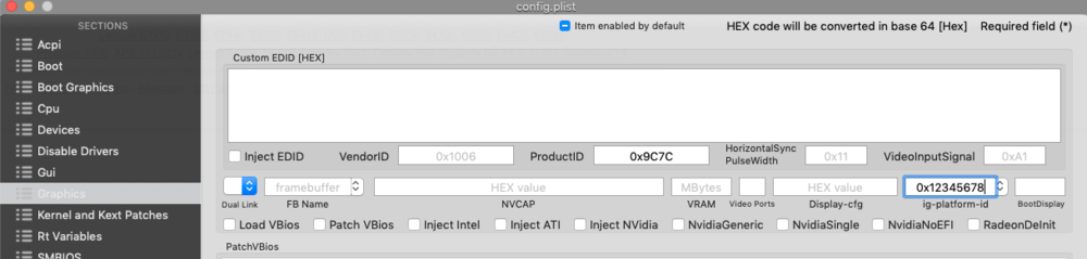

Jake Lo 1391 Report post Posted February 16 That's your graphics relating to DVMT. There's a patch in the Config already to fix the problem but the Skylake FB kext must be cached to be hotpatched. So that tells me your cache is broken. You can try 2 things: 1) Set the DVMT in the BIOS and you won't have to deal with the hotpatching anymore. See here 2) At Clover boot, go to Options, set the ig-platform-id to 0x12345678, this will allow you to boot into OSX without QE/CI. Once there, rebuild your cache Reboot normally 1 Quote Share this post Link to post Share on other sites

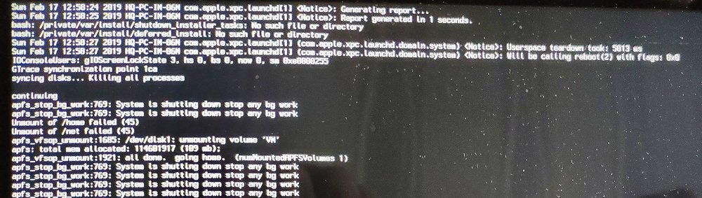

catmater 9 Report post Posted February 17 Can't help. 1. here i set 0x12345678 2. Boot without normal graphics card init (14mb) 3. and i do sudo touch /System/Library/Extensions && sudo kextcache -u / 4. Reboot and have same error Shutdown process generate some report: Quote Share this post Link to post Share on other sites
Jake Lo 1391 Report post Posted February 17 try sudo nvram -c Quote Share this post Link to post Share on other sites
