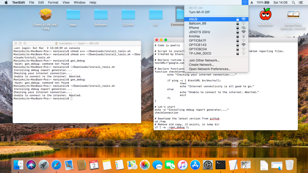

ManiaKsLV Posted March 2, 2019 Author Share Posted March 2, 2019 25 minutes ago, Jake Lo said: Post debug file without internet connection this don't work Link to comment Share on other sites More sharing options...
ManiaKsLV Posted March 2, 2019 Author Share Posted March 2, 2019 14 minutes ago, ManiaKsLV said: without internet connection this don't work Link to comment Share on other sites More sharing options...

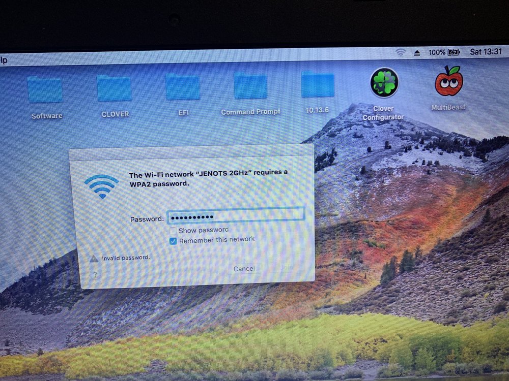

ManiaKsLV Posted March 3, 2019 Author Share Posted March 3, 2019 Have anyone fix K55VM Wi-Fi... I have for my wi-fi this weird behavior i see all networks around but can''t join with right password... I would upload screenshots from macos but i need net for that Link to comment Share on other sites More sharing options...
ManiaKsLV Posted March 3, 2019 Author Share Posted March 3, 2019 LAN works great... And still don't know how to make debugging... now mac os boot without USB... can't do update from app store to system cause bootloop with apple logo. Fresh install were needed System by it self works snappy and responsive without lags.... only problem what i have is with wifi.... i think hardware change will be better solution... Link to comment Share on other sites More sharing options...
ManiaKsLV Posted March 3, 2019 Author Share Posted March 3, 2019 this one https://www.amazon.com/AzureWave-AW-NB097H-AW-NB100H-AW-NB126H-PCI-Express/dp/B00UGSRU22 its AR9485 i think Link to comment Share on other sites More sharing options...
ManiaKsLV Posted March 3, 2019 Author Share Posted March 3, 2019 Found this one... He replace wifi module. So i will do the same... strange i can see wifi networks but cant connect with AR9485... i thought it just don't work Link to comment Share on other sites More sharing options...

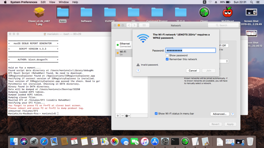

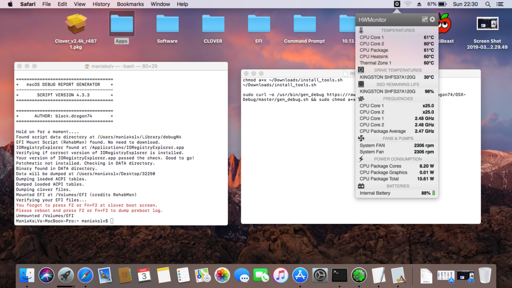

Moderators Jake Lo Posted March 3, 2019 Moderators Share Posted March 3, 2019 Artheros are no longer supported in Mojave, better to stay away from them. Go with Broadcom chipset. For the Debug to work, you need to follow the instruction properly. Reboot to Clover, press F2 and F4 Or Fn+F2 and Fn+F4 Then run the debug again. Link to comment Share on other sites More sharing options...
ManiaKsLV Posted March 4, 2019 Author Share Posted March 4, 2019 7 hours ago, Jake Lo said: Artheros are no longer supported in Mojave, better to stay away from them. Go with Broadcom chipset. For the Debug to work, you need to follow the instruction properly. Reboot to Clover, press F2 and F4 Or Fn+F2 and Fn+F4 Then run the debug again. I have High sierra 10.13.6 didn't find way to install Mojave on my laptop. Always failed or corrupted installation with Mojave. Ok will try with F2 and F4. Link to comment Share on other sites More sharing options...
ManiaKsLV Posted March 4, 2019 Author Share Posted March 4, 2019 7 hours ago, Jake Lo said: Artheros are no longer supported in Mojave, better to stay away from them. Go with Broadcom chipset. For the Debug to work, you need to follow the instruction properly. Reboot to Clover, press F2 and F4 Or Fn+F2 and Fn+F4 Then run the debug again. debug_25168.zip Debug done. Link to comment Share on other sites More sharing options...
