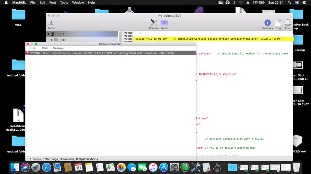

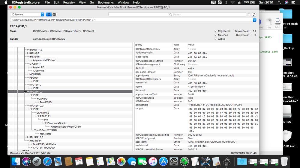

Why on earth would you re-install High Sierra? Clearly you just have to adjust the code a little so that you can patch your DSDT...

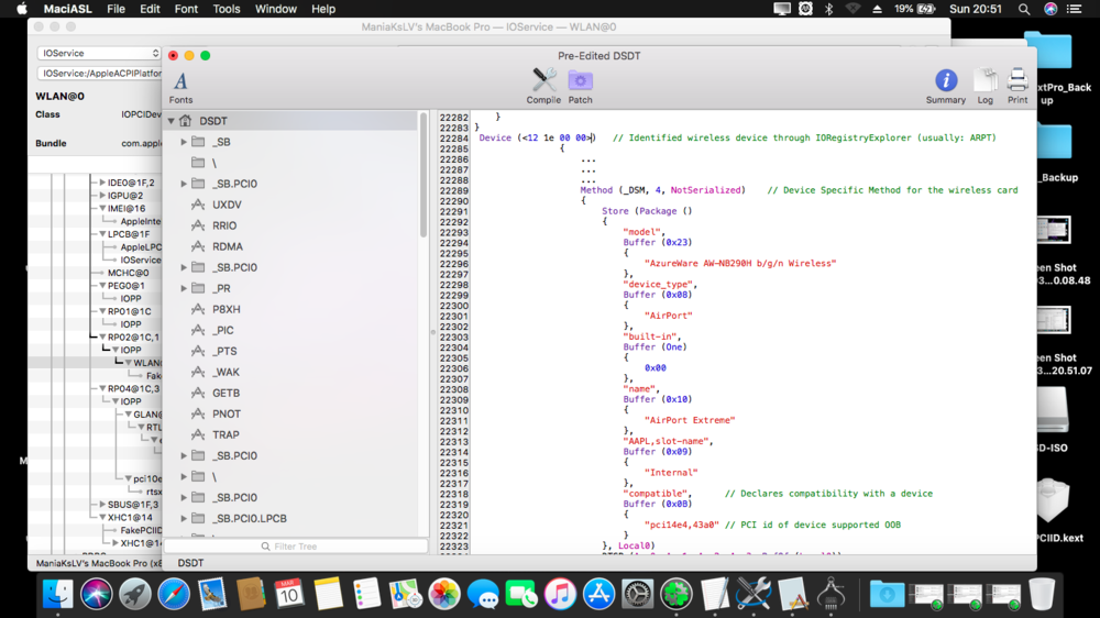

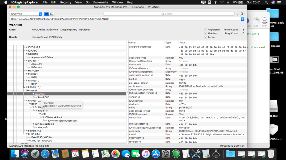

Your IOREg shows that your wireless card appears to be attached to device called WLAN, itself located under parent device RP02; so that your target device for patching. Then you simply don't just copy paste the sample I posted, especially the "..." lines! They're meant to summarize code to ignore.
Instead, under the device called WLAN, copy/paste the _DSM method, adjusting the name of the model to AW-CE123H, instead of what's provided in my sample code.
You won't be able to recompile your DSDT properly until you do that. But, by all means, post your initial DSDT file for patching.

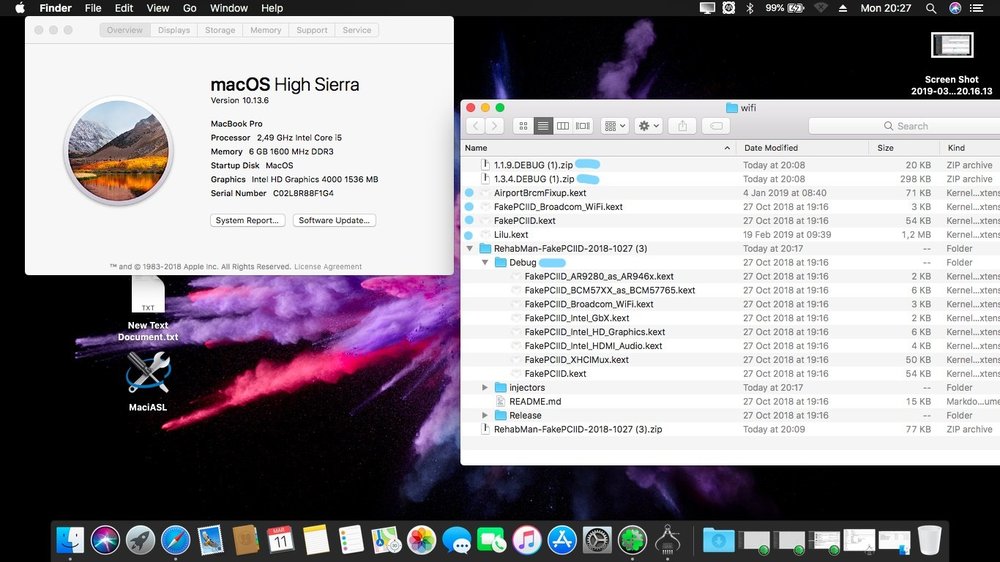

So i downloaded Lilu.kext 1.3.4 + AirportBrcmFixup.kext 1.1.9
and RehabMan-FakePCIID-2018-1027.zip who contains FakePCIID.kext + FakePCIID_Broadcom_WiFi.kext
i used this folders

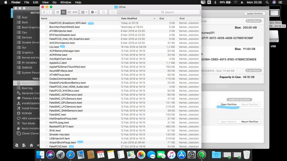

then copy files in CLOVERS kext folder

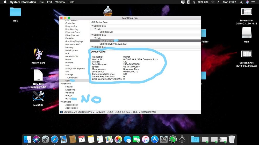

Did i do something wrong? or all i mention is right.
@ManiaKsLV, can you please confirm what wireless card is currently fitted in your laptop?
Reason I ask is because, on looking at your DSDT, I could not help but notice the following DSM method under device WLAN which basically injects properties of an Atheros AR9285 card! So... :blink:

If you wish to inject properties for the AzureWave AW-CE123H, the above has to be replaced! By something like the following...

Faking Broadcom device 14e4:43a0 whilst retaining your current Atheros properties injection will not work... Remove the Clover faking and try the DSDT attached below.
DSDT.zip

For your AW-CE123H, just follow the instructions at the end of my previous post. You may also cleanup your kexts folder and remove all those related to Atheros hardware. If you also update to the latest Lilu + WhateverGreen + AppleALC, you should no longer need those old Shiki + IntelGraphicsFixup kexts that are now outdated.
