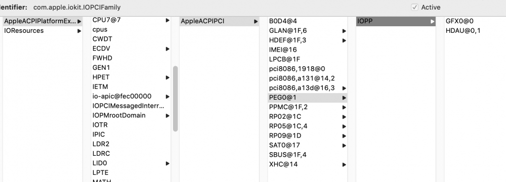

nickelnoff Posted October 14, 2019 Author Share Posted October 14, 2019 @kushwavez agree to a point. Never used windows much on this system. I seem to recall when the system was first bought through I was getting a little bit not load more battery life. But then NVidia dGPU was not disabled. i was however getting 3+ hours battery life with Ubuntu 18.04 though. Again with NV disabled. As you say could just be the OS but I suspect there is some thing draining since I’ll get jump decreases when doing things like rebooting. another thing I have seen is that the fans can be noisy and then I’ll sleep the system and wake and the fans have quieted down and battery drain seems to have slowed. @Hervé I removed the UEFI disabled method last night and ran a CMOS reset to get back to default settings. Clover now shows (under Graphics option) both GPUs a present however unable to boot successfully back in to Mojave. Kernel panic seems to occur followed by a reboot. I tried removing boot option: -wegnoegpu tried adding -nv_disable=1 tried adding checking InjectNvidia using FakeId: 0x12345678 any suggestions on how to proceed? Link to comment Share on other sites More sharing options...

nickelnoff Posted October 14, 2019 Author Share Posted October 14, 2019 10 minutes ago, Jake Lo said: You need to enable Switchable graphics in the BIOS. Thanks @Jake Lo- managed to get booted up. I seemed to have needed to clear other config renames out as well as SSDTs - not entirely sure what was responsible but now writing on very choppy graphics with the NV dGPU running. Will try and disable. Any help appreciated. Currently seeing: DSDT.dsl.zip Link to comment Share on other sites More sharing options...
