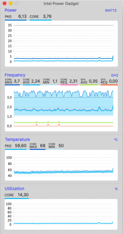

i noticed with intel power gadget that the igpu is always at 0.55ghz and only going up, but never going down even when idle. Isn't it supposed to be at 0 when under no load?

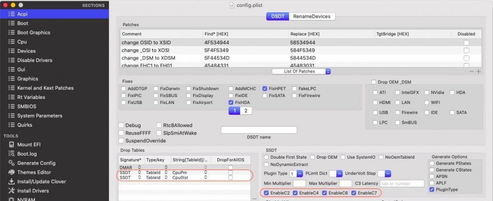

I'd say your battery drain issue has more chance to result from your incorrect CPU power management settings:
You have a Haswell platform so all you need is:
ACPI tab:
  • Plugin Type set to 1
  • PluginType enabled
Kernel & Kext Patches:
  • KernelPm
  • (you can keep AppleRTC patch of course!)

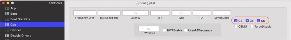

Nothing else. So remove those incorrect SSDT drops (especially as you're not using any CPU-specific generated SSDT) and those C-States you've enabled. Also, what is that SSDT-PNOT table you use? Not necessary to me...
Thank you very much for your answer.
C States are supposed to be idle states and should improve battery life, that was my guess, and they sure did no hurt when i did these (igpu issue was already there). I removed them anyway and also the acpi drops, CPU still idles at 800mhz.

  • remove the connector patches under devices (not the stolen memory patches)
  • disable the dock patch in kexts to patch
  • disable all the C states checkboxes (actually made no difference in idle pkg consumption)
  • gonna remove PNOT (i got that in the bootpack..)

As for iGPU idling at 0MHz, I confirm that it's not possible. If using Intel Power Gadget, maybe OP confused OS required graphics frequency and actual iGPU frequency... Here's the registered behaviour of the HD4000 iGPU of the i7-3540M of my idle Latitude E6230 under Catalina 10.15.6:
OP did not indicate anything on his E7240 specs or post an IOReg extract, so maybe it's just a matter of having an AMD dGPU fitted but not disabled... Who knows?
