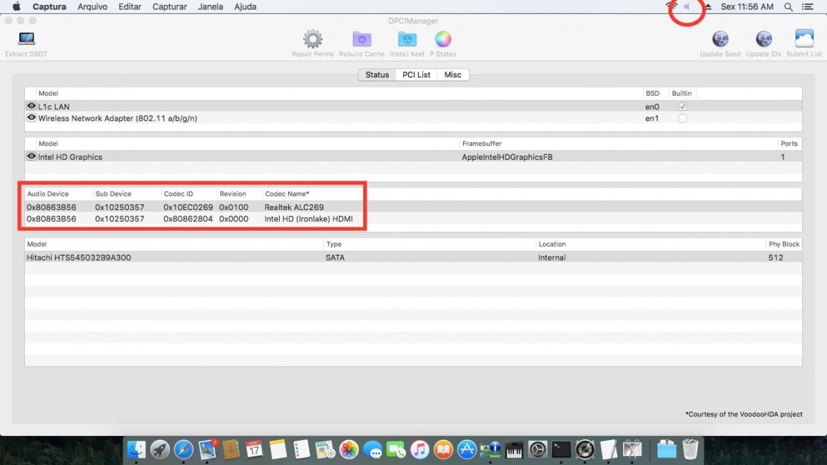

vinicius_sampaio Posted March 17, 2017 Share Posted March 17, 2017 Tank you for your help @Jake Lo. I already tried this. I may have done something wrong and I do not know where. I'm using voodoohda with patched IOAudioFamily but audio lost sync after a certain time. I have a acer aspire 4745z laptop and another problem is the jack in voodoohda, which is manual. Link to comment Share on other sites More sharing options...
vinicius_sampaio Posted March 17, 2017 Share Posted March 17, 2017 When I use the AppleHDA patcher, my device appears but I do not have functional audio. See the picture. Link to comment Share on other sites More sharing options...
Moderators Jake Lo Posted March 21, 2017 Moderators Share Posted March 21, 2017 DPCIManager shows it has ALC269 rather than ALC271x, you might give that a try. 1 Link to comment Share on other sites More sharing options...
vinicius_sampaio Posted March 22, 2017 Share Posted March 22, 2017 I'm confuse... My linux dump says "Codec: Realtek ALC271x" Link to comment Share on other sites More sharing options...
Moderators Jake Lo Posted March 22, 2017 Moderators Share Posted March 22, 2017 If you look down to vendor ID: you'll see 0x10ec0269 See if this works, seems to be similar issue with Acer Link to comment Share on other sites More sharing options...
