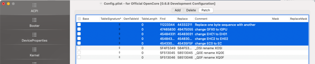

Decompiled DSDT with command "./iasl-stable -l DSDT.aml" to get hex code find _REG and replace to XREG verified with hex-friend _REG 5F 52 45 47 02 is unique as well as XREG 58 52 45 47 02.  Added rename patch to Config.plist.  Boot and checked System DSDT,  _REG is renamed to XREG and inserted this method into SSDT.

Screwed up can't change _INI to XINI there were too many methods with _INI have to fix that, I have to add 1C, find  1C 5F 49 4E 49 00 replace 1C 58 49 4E 49 00.  Funny when searched in Hex-Friend only found "5F 49 4E 49 00" once weird.
Edited add the 1C to make it unique checked DSDT its all good now but still no LED.
