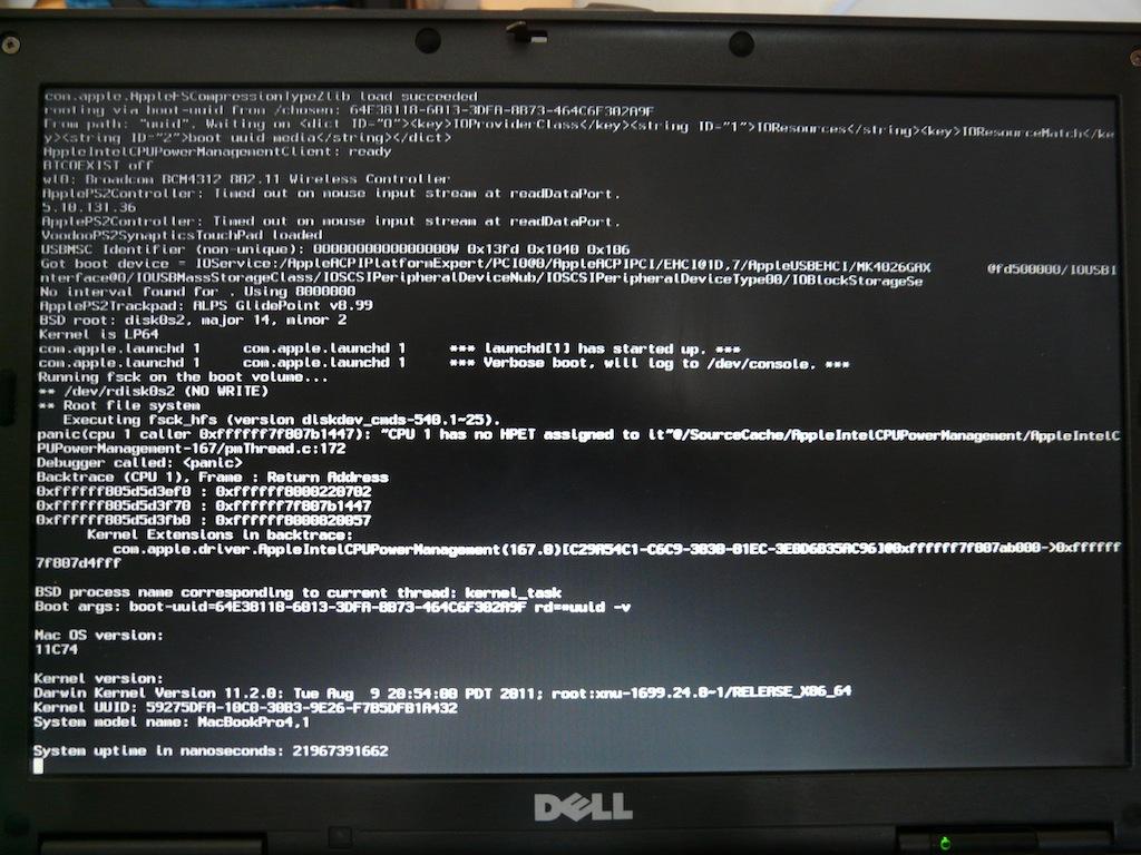

iMick Posted July 14, 2012 Share Posted July 14, 2012 Could you please boot with -v and make a picture of your screen? What Lion version do you have? (10.7.x?) We will solve that bugs . Link to comment Share on other sites More sharing options...
Administrators Hervé Posted July 14, 2012 Author Administrators Share Posted July 14, 2012 Here it is: I had just installed Lion 10.7.2 successfully through the recommended method, i.e. myHack 3.1 (the latest version). To avoid any confusion, please note the following: 1) after Lion 10.7.2 installation, the USB HDD was not bootable -> complained about GPT error as if Chameleon did not properly install. 2) I rebooted onto internal SATA HDD with SL and installed Chameleon on the USB HDD 3) I then rebooted onto the USB HDD and completed the Lion 1st boot settings 4) Having completed those settings, I proceeded with EDP 3.1 v366 installation (installed pre-defined values for kexts) 5) On reboot, got above KP Interestingly enough, if I boot via internal SATA HDD Chameleon, I can boot Lion! ??? Link to comment Share on other sites More sharing options...
Administrators Hervé Posted July 14, 2012 Author Administrators Share Posted July 14, 2012 'appears I had no 'org.chameleon.Boot.plist', no 'smbios.plist' and no 'dsdt.aml' files under /Extra! On copying the plist files + DSDT table from the USB installation key, I'm back in business. Could there be something within the latest EDP that causes this problem? Link to comment Share on other sites More sharing options...
