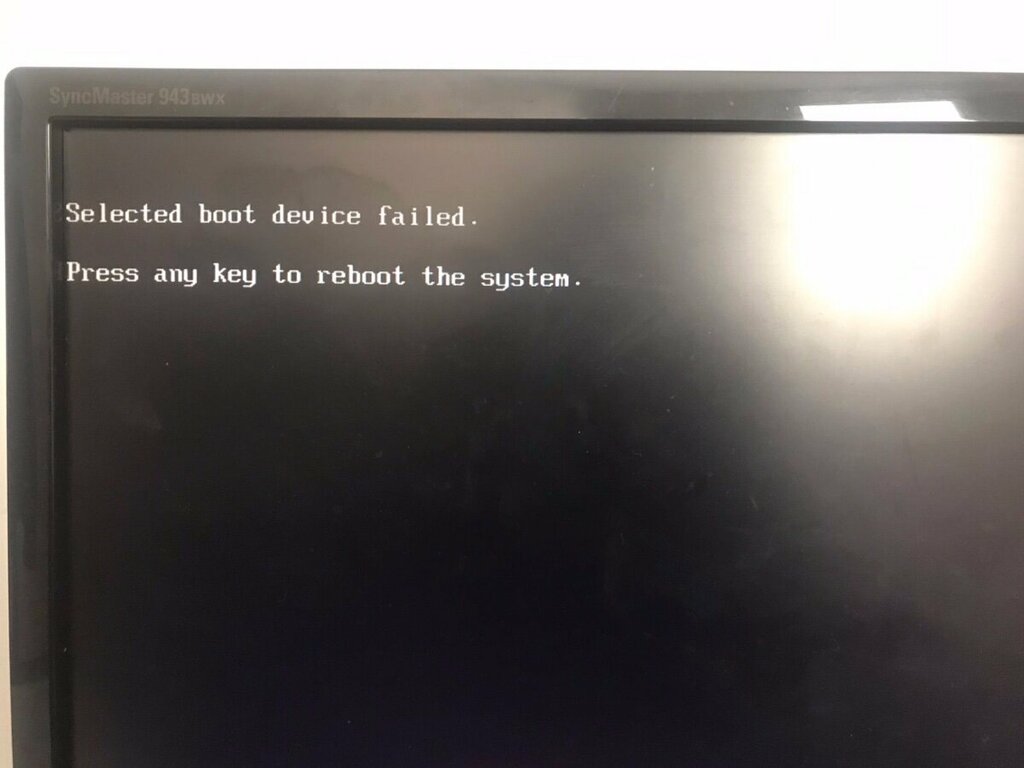

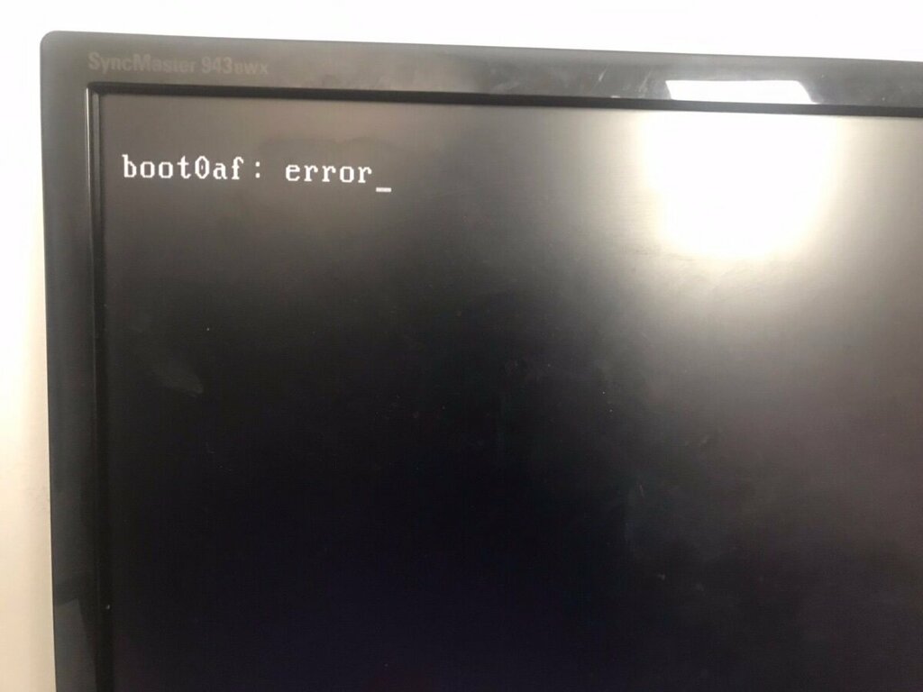

everton oliveira Posted September 17, 2021 Author Share Posted September 17, 2021 I tried to use this and I got this error, as you can see attached I'm using a22 bios revision, the last avaiable Link to comment Share on other sites More sharing options...
Moderators Jake Lo Posted September 17, 2021 Moderators Share Posted September 17, 2021 I read a few forums that suggest formatting the EFI partition to fat32 from Windows and not from MacOS, then copy the EFI folder over. Link to comment Share on other sites More sharing options...
Administrators Hervé Posted September 17, 2021 Administrators Share Posted September 17, 2021 Looks like your USB installer is not bootable. Was the key formatted HFS, APFS or FAT32. How did you install Clover, with what selected options/settings? Edit: with regards to formatting the EFI partition FAT32, the Clover instructions have always worked for me: Link to comment Share on other sites More sharing options...
