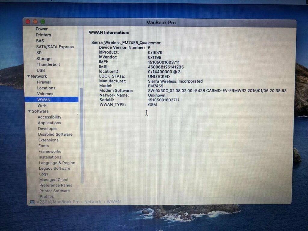

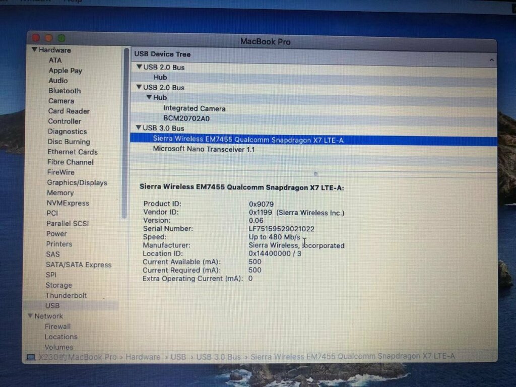

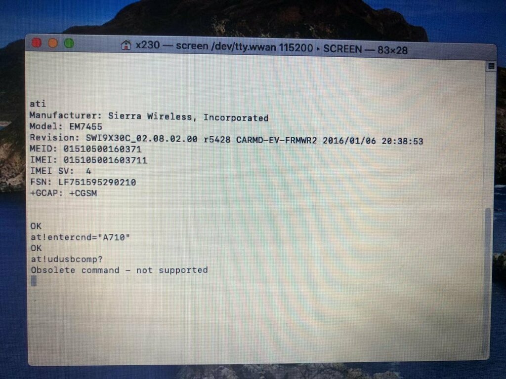

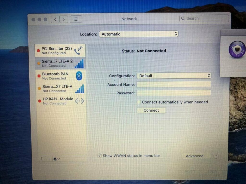

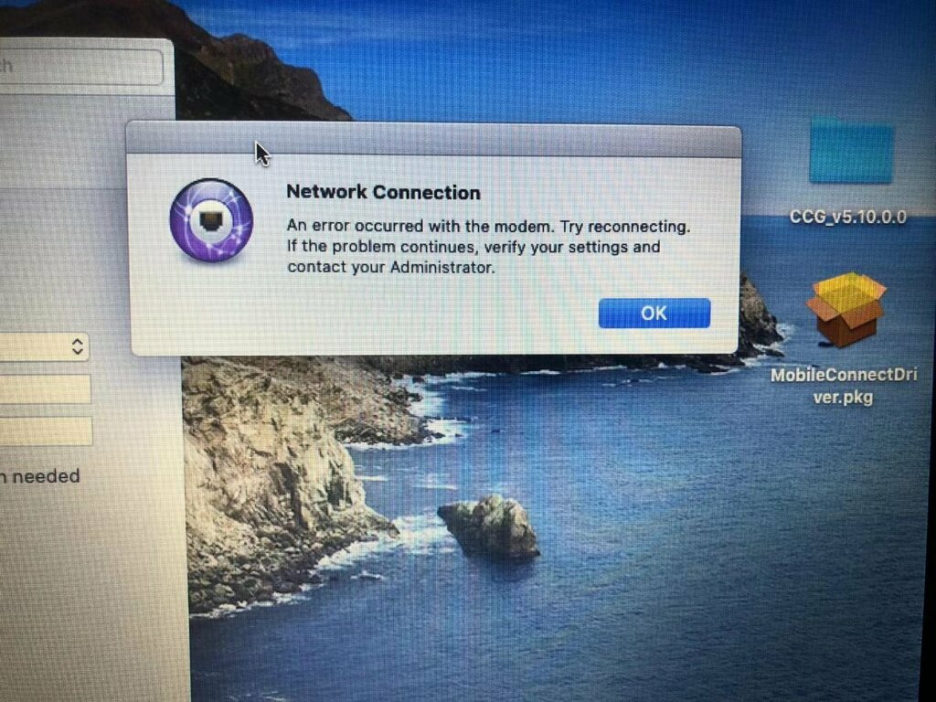

LTE-Card Posted November 23, 2021 Share Posted November 23, 2021 laotop: lenovo X230 wwan card : em7455 lenovo version MacOS :10.15.5 I put the sierra wireless em7455 in my Sandy Bridge/HD4000 X230 laptop . it's good work in windows and linux then i want it work in Catalina 10.15.5 The usb and wwan is show hardware ,but not work So i think maybe need enable com6 or com8 , I try it, but not sucessful what's command that i can do it Thanks Link to comment Share on other sites More sharing options...
Administrators Bronxteck Posted November 23, 2021 Administrators Share Posted November 23, 2021 try using the commands from this thread but change them to suit your hardware. i dont think the drivers will work for you so disregard that part i guess. https://decovar.dev/blog/2019/04/17/huawei-e3372-macos/ Link to comment Share on other sites More sharing options...
Administrators Hervé Posted November 23, 2021 Administrators Share Posted November 23, 2021 @LTE-Card Did you check the Sierra Wireless web site at all? Because the Sierra Wireless EM74xx AT Command Reference manual is available here... at sierrawireless.com! Simple no-brainer account registration required. Also available here, again with account registration though through a more complicated process it would seem. 4117727 AirPrime EM-MC74xx AT Command Reference r4.pdf.zip For the rest, I assume you know that you have to define the APN parameters for the connection you want to initiate; parameters depend on your service provider/Telco. You may also want to use the standard keyboard shortcuts to take screenshots rather than pictures with a cellphone... Link to comment Share on other sites More sharing options...
