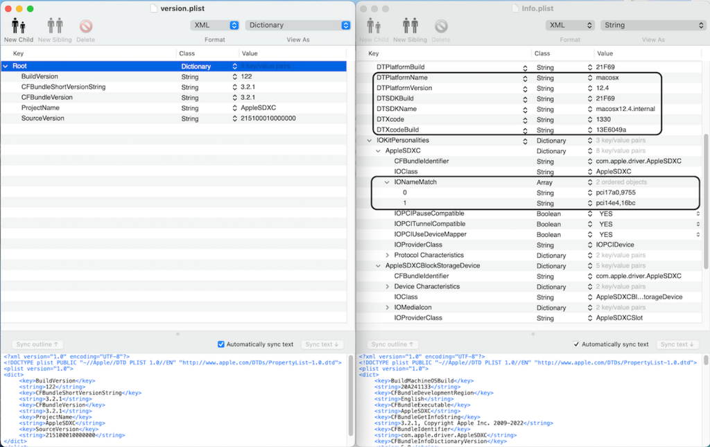

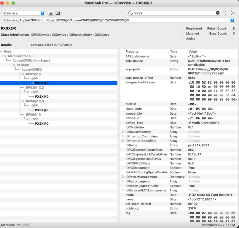

George1203 Posted June 24, 2022 Share Posted June 24, 2022 I almost finished the hackintosh of Lenovo Y520 with OC in MacOS Monterey. There are two features not working including O2 SD Card Reader and sleep-black screen. Wifi and BT are working with Broadcom 94360NG, air-drop and hand-off OK. Patch the SSDT-SDCard.aml or define the Device Property is the same result, that only show the SDCard Reader is detected but without AppleSDXC.kext. In the Kernel patched AppleSDXC.kext and AppleSDXCInjector.kext are not work. I try to block, Force or patch is still no work. In the original AppleSDXC I find the IONameMatch pci17a0,9755 and pci14e4,16bc, as I change the compatible to pci17a0,9755, macOS system report show the device driver is on but actuarially is block by the sub driver of AppleSDXCBlockStorageDevice. Here are the attched files as below, Could you help me to verify the problem and thank you very much. ACPI_SSDT.zip configOC.plist.zip DSDT.aml.zip MacBook Pro.ioreg.zip Link to comment Share on other sites More sharing options...

George1203 Posted June 26, 2022 Author Share Posted June 26, 2022 the xprw can not fix sleep issue, mouse and keybord seems no work after sleep enable the aspi of Change _OSI to XOSI and replace the subsystem-vendor-id same as Broadcom wifi is still no work i have to add the patch of SSDT-SDCard.aml in order to get the reulit as below (deteted and no driver on) Link to comment Share on other sites More sharing options...
Moderators Jake Lo Posted June 26, 2022 Moderators Share Posted June 26, 2022 look under card reader, not PCI, that's just for cosmetics only. Link to comment Share on other sites More sharing options...

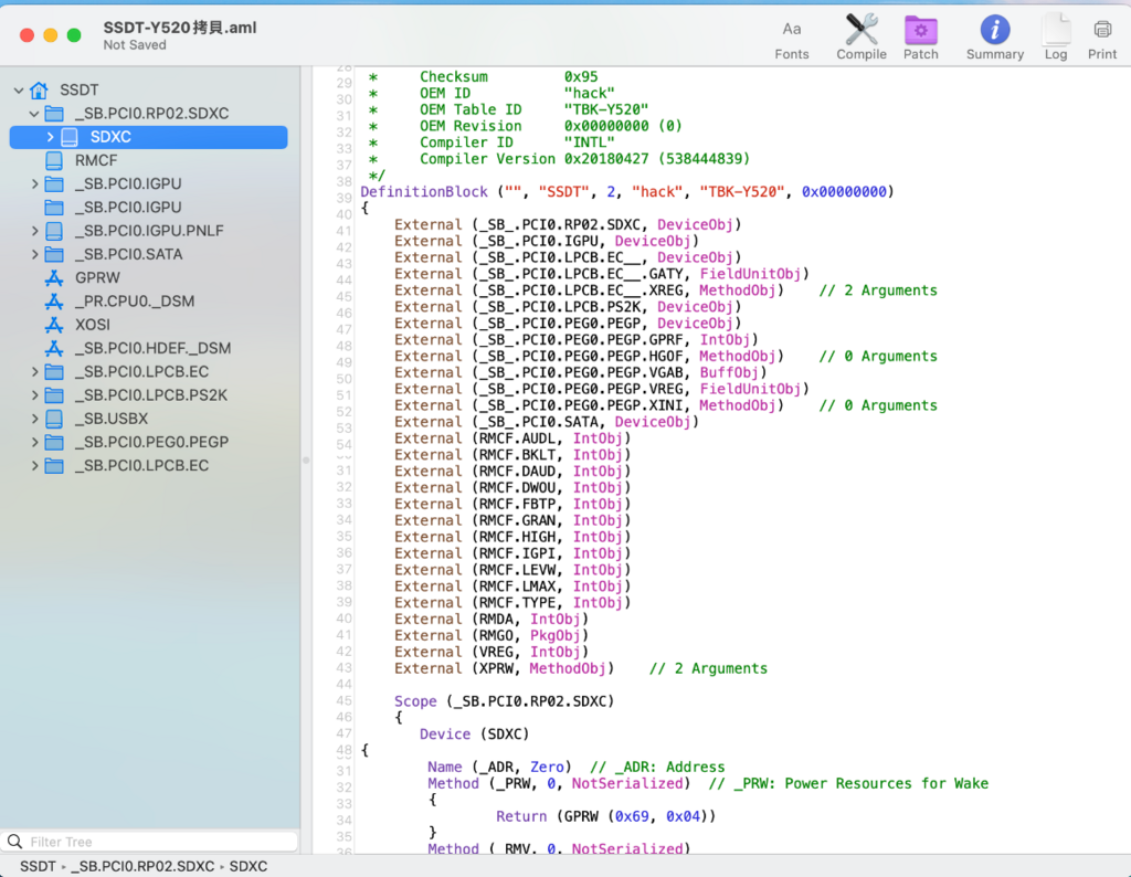

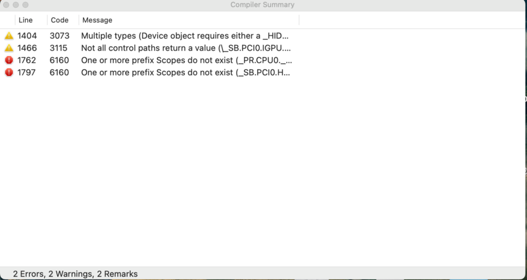

George1203 Posted June 26, 2022 Author Share Posted June 26, 2022 Crad reader is nothing Could we try to add the PR02.SDXC into the patch of SSDT-Y520.aml Device (SDXC) { Name (_ADR, Zero) // _ADR: Address Method (_PRW, 0, NotSerialized) // _PRW: Power Resources for Wake { Return (GPRW (0x69, 0x04)) } Method (_RMV, 0, NotSerialized) { Return (0x00) } } **the Return (GPRW (0x69, 0x04)) need to check 0x69, 0x04 is correct I try to add but i have no idea compile I just want to chang the PR02 PXSX to SDXC, befor the code of Device (SDXC) should add Device(PR02) sorry i am a new guide and no skill of any computer language Link to comment Share on other sites More sharing options...
