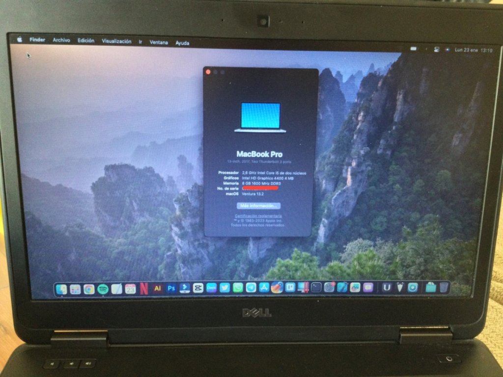

Andres Galeano Posted Wednesday at 12:29 PM Author Share Posted Wednesday at 12:29 PM Excuse me, it's the pure reality, I was able to install it but the graphics acceleration is not working. Just like I have noticed that at 2:10 after being turned on the laptop restarts automatically. Attached my caperta efi and config. Config.zip Download EFI Quote Link to comment Share on other sites More sharing options...

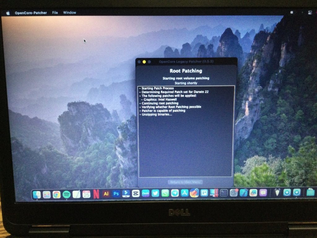

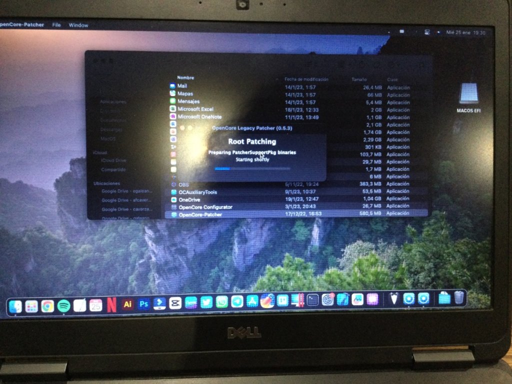

Moderators Jake Lo Posted Wednesday at 03:48 PM Moderators Share Posted Wednesday at 03:48 PM You'll need to: disable SIP. Just change csr-active-config to 03080000 Add this to bootarg as well amfi_get_out_of_my_way=0x1 On reboot, reset NVRam Download OCLP 0.5.x Selected "Post Install Root Patch" -> Start Root Patches Rebooted system - > full graphics acceleration 1 Quote Link to comment Share on other sites More sharing options...
Andres Galeano Posted Wednesday at 06:08 PM Author Share Posted Wednesday at 06:08 PM Thanks, I'll be doing the test and giving you feedback. after trying it no longer restarts but remains frozen 1. Force reboot 2. Started and quickly started the OCLP 0.5.3 process and froze again on this process but got a little further along Quote Link to comment Share on other sites More sharing options...
Administrators Hervé Posted Wednesday at 07:22 PM Administrators Share Posted Wednesday at 07:22 PM You must revert to the SMBIOS of unsupported Haswell platform for the OCLP patch to work: MBP11,x or MBA6,2. You installed Ventura with SMBIOS MBP14,1 which is a Kaby Lake platform. That's unsuitable for OCLP patching. Make sure you apply the OCLP root patches and absolutely nothing else on your Hackintosh. Quote Link to comment Share on other sites More sharing options...

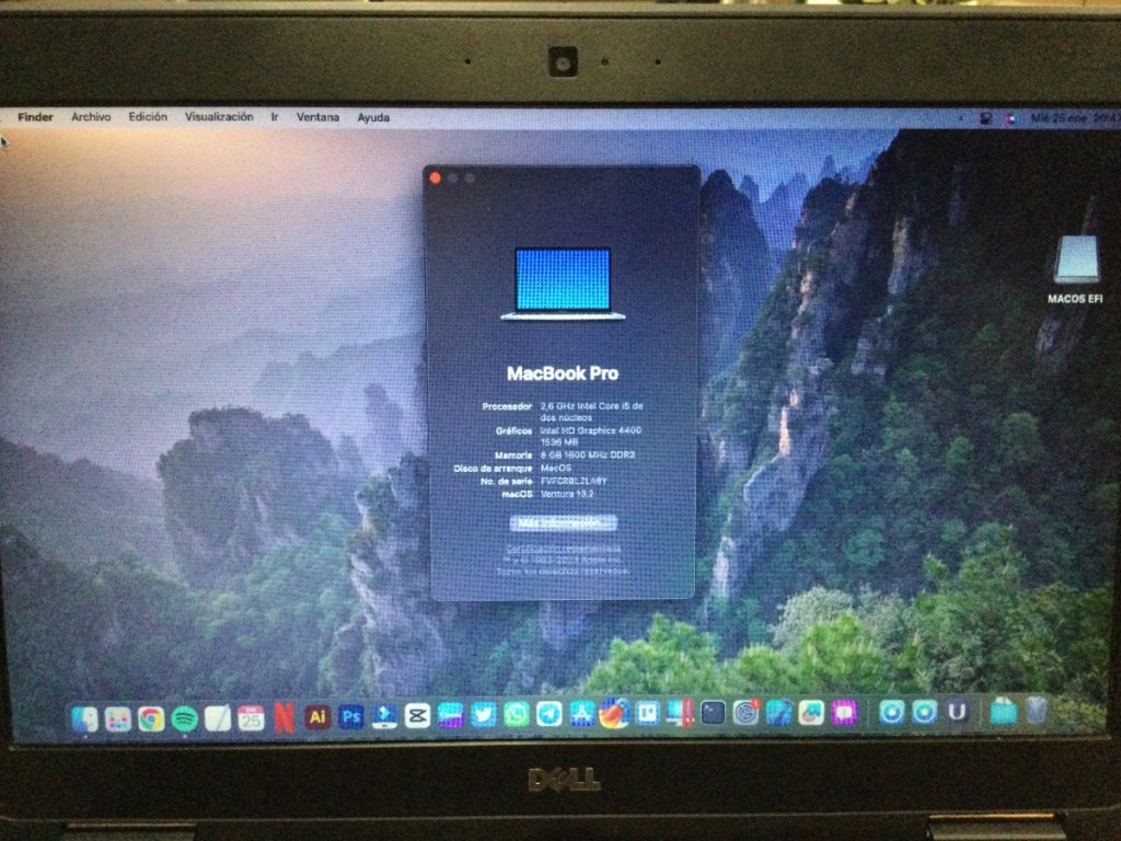

Andres Galeano Posted Wednesday at 07:38 PM Author Share Posted Wednesday at 07:38 PM The question is that I realized that without changing the SMBIOS the installer does not start and that by making the change in the config.plist I was able to start. What do you recommend? graphics acceleration enabled The freezing problem continues but without automatic restart. You have to force shutdown. Quote Link to comment Share on other sites More sharing options...
Administrators Hervé Posted Wednesday at 07:50 PM Administrators Share Posted Wednesday at 07:50 PM Perfectly normal; you can't install Ventura without a supported SMBIOS; same goes for OTA updates. Once Ventura is installed, revert to Haswell SMBIOS and boot with -no_compat_check boot arg. Then apply the OCLP root patches. 1 Quote Link to comment Share on other sites More sharing options...

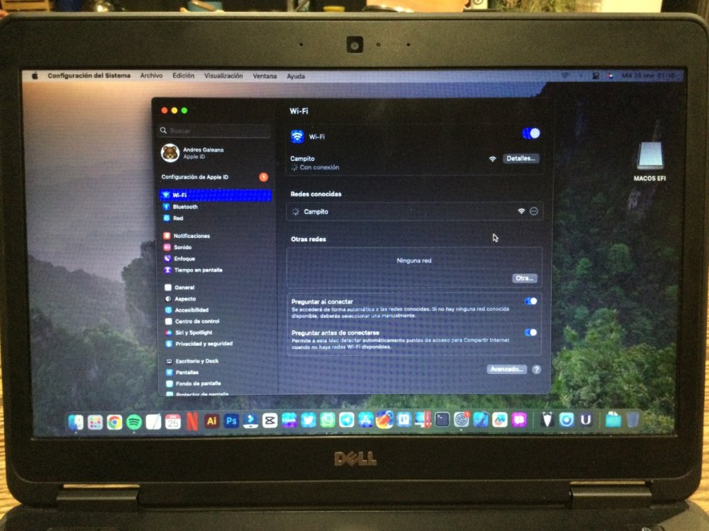

Andres Galeano Posted Wednesday at 07:54 PM Author Share Posted Wednesday at 07:54 PM Excellent, I'll do it myself and try it, thank you very much We have made a lot of progress, now the question is that it detects all Wi-Fi networks but when trying to connect it freezes again, I pass files to corroborate. another problem: no sound Quote Link to comment Share on other sites More sharing options...
