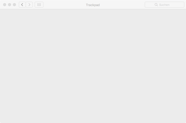

Neo.aka.Darkman Posted August 30, 2016 Share Posted August 30, 2016 Hi. Same by me. Trackpad PrefPanel is empty. Latest Sierra Developer beta. ApplePS2SmartTouchPad v. 4.6.5. ELAN v.3 kernel: (ApplePS2Controller) STD :: Enhanced Apple PS2 Controller and Keyboard driver v4.6.5 Copyright (c) EMlyDinEsH <www.osxlatitude.com> 2012-2016. kernel: (ApplePS2Keyboard) STD :: Initializing keyboard... kernel: (ApplePS2Keyboard) STD :: Keyboard echo success. kernel: (ApplePS2Keyboard) STD :: Keyboard enabled. kernel: (ApplePS2SmartTouchPad) STD :: Smart PS2 Touchpad v4.6.5 Copyright (c) EMlyDinEsH <www.osxlatitude.com> 2012-2016. kernel: (ApplePS2SmartTouchPad) STD :: Detecting the touchpad... kernel: (ApplePS2SmartTouchPad) STD :: ELAN touchpad found, Hardware version 3 (Firmware version 0x450f00) kernel: (ApplePS2SmartTouchPad) STD :: ClickPad? No kernel: (ApplePS2SmartTouchPad) STD :: Capabilities query result 0x08, 0x15, 0x0c. kernel: (ApplePS2SmartTouchPad) STD :: Touchpad ranges are X_min 0 Y_min 0 X_max 2508 Y_max 1320, CenterX 1254, CenterY 660. kernel: (ApplePS2SmartTouchPad) STD :: OS X version 10.12.0 kernel: (ApplePS2SmartTouchPad) STD :: Touchpad enabled. Link to comment Share on other sites More sharing options...
Administrators Bronxteck Posted August 30, 2016 Administrators Share Posted August 30, 2016 latest as in yesterday release version developer 8 or public beta 7? Link to comment Share on other sites More sharing options...
Administrators Bronxteck Posted August 30, 2016 Administrators Share Posted August 30, 2016 hmm ok in the kext info.plist file at the bottom of the list is a section <key>OSBundleLibraries</key><dict> under that entry add <key>com.apple.iokit.IOHIDFamily</key> <string>1.4</string> it should look like this after <key>OSBundleLibraries</key> <dict> <key>com.apple.iokit.IOHIDFamily</key> <string>1.4</string> <key>com.apple.iokit.IOHIDSystem</key> <string>1.0.0b1</string> <key>com.apple.kpi.iokit</key> <string>9.0.0</string> <key>com.apple.kpi.libkern</key> <string>9.0.0</string> <key>com.apple.kpi.mach</key> <string>9.0.0</string> <key>org.emlydinesh.driver.ApplePS2Controller</key> <string>4.6</string> <key>org.emlydinesh.driver.ApplePS2Keyboard</key> <string>4.6</string> </dict> then save changes and rebuild your cache if it is in S/L/E or E/E... if it is in clover folder then boot without caches. Link to comment Share on other sites More sharing options...

a1k0n Posted September 12, 2016 Share Posted September 12, 2016 Install ApplePS2Smart.... to EFI_Extensions or /S/L/E and restore Trackpad.prefPane from El Capitan to Sierra (/System/Library/PreferencePanes) reboot and it works 1 Link to comment Share on other sites More sharing options...
