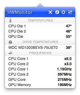

Administrators Hervé Posted May 22, 2013 Administrators Share Posted May 22, 2013 Just to complement this, today I got access to my friend's D830 nVidia (135M) again so I implemented this fine-tuning. The laptop runs ML 10.8.3 on a 2.2GHz T7500 and WXGA 1280x800 LCD, still I used the MBP5,1 settings and all works just fine afterwards: native SpeedStep + GPU clocking. The only differences I see compared to the D630 are the reported GPU core/memory frequencies: 168/100MHz, 275/199MHz and 400/399MHz, where I was seeing higher memory clockings on the D630. Can't see any obvious performance impact though, everything remains very smooth. The reported T° appear excellent too: CPU idles around 45-48°C and GPU around 54-55°C at 168/100MHz. I noticed a Tjmax at 90 in the system log so I manually edited the CPUSensors kext's plist to set Tjmax to 100 (previously, this sort of things was done in IntelCPUMonitor kext), otherwise reported CPU T° are a good 10° lower. XBench 32bit gave me a result of 3063 on 1st run (D830 has 2Go DDR2-667 and 120Go 5400rpm HDD). NB: MB5,1 and/or MBP5,1 SMC ids and SMBIOS profiles can both be used. I did not see any obvious difference between the 2 during my tests (though they were not extensive), although GPU throttling might be a bit quicker with MBP5,1 than MB5,1. MB4,1 settings break native SpeedStep and limit GPU to 275MHz, so that cannot be used. Regardless of the selected SMC id & SMBIOS profile, IDA BIOS mode is not supported with that T7500 CPU: if enabled, FSB speed gets reduced from 200 to 182MHz. That differs from the T9300 with which IDA can be enabled without impact. Link to comment Share on other sites More sharing options...
