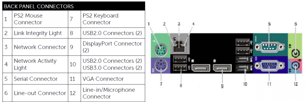

Moderators Jake Lo Posted April 15, 2013 Moderators Share Posted April 15, 2013 Specs: i7 -3770 | 4GB ram | HD4000 | 128GB SSD | Mountain Lion 10.8.5 | Mavericks | BIOS A14 Very easy build. Build USB Installer with myHack with generic Extra folder Extract my Extra - Opt9010 folder to USB drive Extra - Opt9010.zip Boot with USB Installer ( Make sure to plug monitor to displayport/DVI, vga is not supported) When prompt, select "Use My Own" and point to Extra - Opt9010 Select Yes 3 times to delete issue kexts Ignore the Install Failed error at the end, just restart the computer Complete the install Done. What's working: HD 4000 Full QE/CI Dual display is working with the 2 built-in DisplayPort Sleep works if set manually (fixed with DSDT) Built-in Speaker / Headphone jack Update: Installed Mavericks DP4 and then update to GM (13A603) with same boot pack, no issue. Same instructions above except added switches "-v -f" to step 3. December 03, 2013 Bronxteck found a solution to get USB3 loaded. Download GenericUSBXHCI.kext to Extra/Extension.You need to get a patched DSDT. Just extract a clean DSDT from Chameleon. Search for "Windows 2009" and change it to "Darwin". Add the DSDT to Extra and reboot. Bam! USB3 enabled. Sleep works now too! UPDATE! Yosemite Guide can be found here. Bootpack is on post #5 of the guide 2 Link to comment Share on other sites More sharing options...

AlexPeng Posted May 18, 2013 Share Posted May 18, 2013 DELL 9010DT Specs: i7-3770/8GB Ram/HD4000/500GB HDD 1,Build USB Installer with myHack with generic Extra folder 2,Extract Extra - Opt9010 folder to USB 3,Boot with USB Installer (VGA is not supported? 9010DT HD4000 Doesn't have a DVI or HDMI! ) VGA is OK to run... 4,Select "Use My Own" and point to Extra - Opt9010 5,Select Yes 3 times to delete issue kexts 6,Install Failed at the end! OS X could not installed on your computer. Ignore Install Failed error and restart, then...could not work ...boot with USB only... any suggestion? Link to comment Share on other sites More sharing options...
Moderators Jake Lo Posted May 18, 2013 Author Moderators Share Posted May 18, 2013 DELL 9010DT Specs: i7-3770/8GB Ram/HD4000/500GB HDD 1,Build USB Installer with myHack with generic Extra folder 2,Extract Extra - Opt9010 folder to USB 3,Boot with USB Installer (VGA is not supported? 9010DT HD4000 Doesn't have a DVI or HDMI! ) VGA is OK to run... 4,Select "Use My Own" and point to Extra - Opt9010 5,Select Yes 3 times to delete issue kexts 6,Install Failed at the end! OS X could not installed on your computer. Ignore Install Failed error and restart, then...could not work ...boot with USB only... any suggestion? You need to get a Displayport to DVI or Displayport to HDMI adapter. Personally, I haven't tested the DP to HDMI adapter, but only DP to DVI adapter which works perfectly. You don't need to rebuild your system, just plug in the adapter and you'll see OSX is installed successfully. Link to comment Share on other sites More sharing options...
iMick Posted May 18, 2013 Share Posted May 18, 2013 DELL 9010DT Specs: i7-3770/8GB Ram/HD4000/500GB HDD Ignore Install Failed error and restart, then...could not work ...boot with USB only... any suggestion? What is exactly your problem? That you can only boot from USB to your installed Mountain Lion, and not from your main drive? Easy to fix! Boot your (installed) Mountain Lion from your USB. When booted, open myHack.app from the install USB. Choose Install myHack Utilities. When done, open again and choose: Install Chameleon. When done, open again and choose: Install Extra. Select the Extra from this first post. After this you should be able to boot from your hard drive, instead of your USB . Link to comment Share on other sites More sharing options...
AlexPeng Posted May 18, 2013 Share Posted May 18, 2013 Thanks for your help, Jake Lo and iMick. I'll test DP to DP connect before buy a DP-DVI adapter. It only can boots from USB, when booted, I choose run the OS X from HDD, comes a restart. Link to comment Share on other sites More sharing options...
