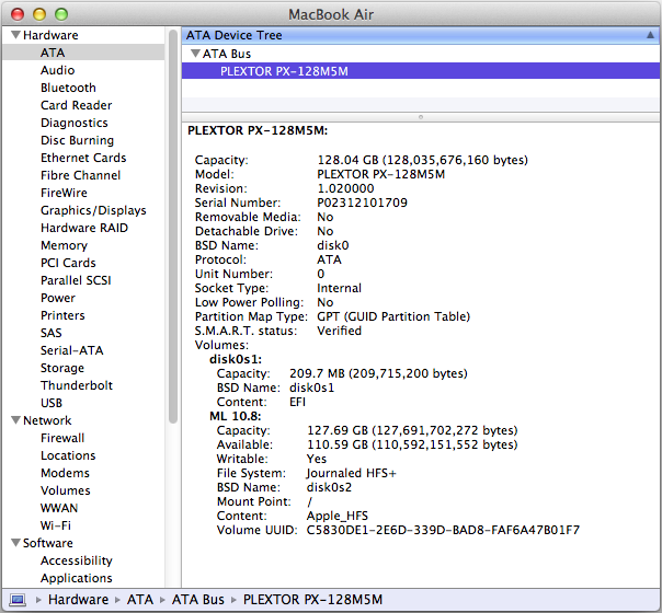

I've also experienced situations where an external USB device (key of HDD) would behave the same and it was a problem of partition scheme/format type: the key or HDD would not be recognized when partitioned GPT with OS X extended format, only if partioned MBR with FAT/FAT32 formatting.
I'd be surprised if you had such similar problem with a SSD but you never know... Or the SSD could simply be slow to get powered up/responsive at POST.
