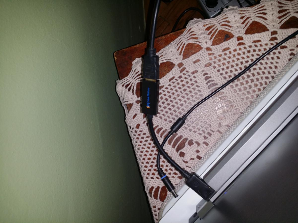

Here's the DisplayPort/HDMI, working in extended mode.
Wish i could get the same combo for VGA.
