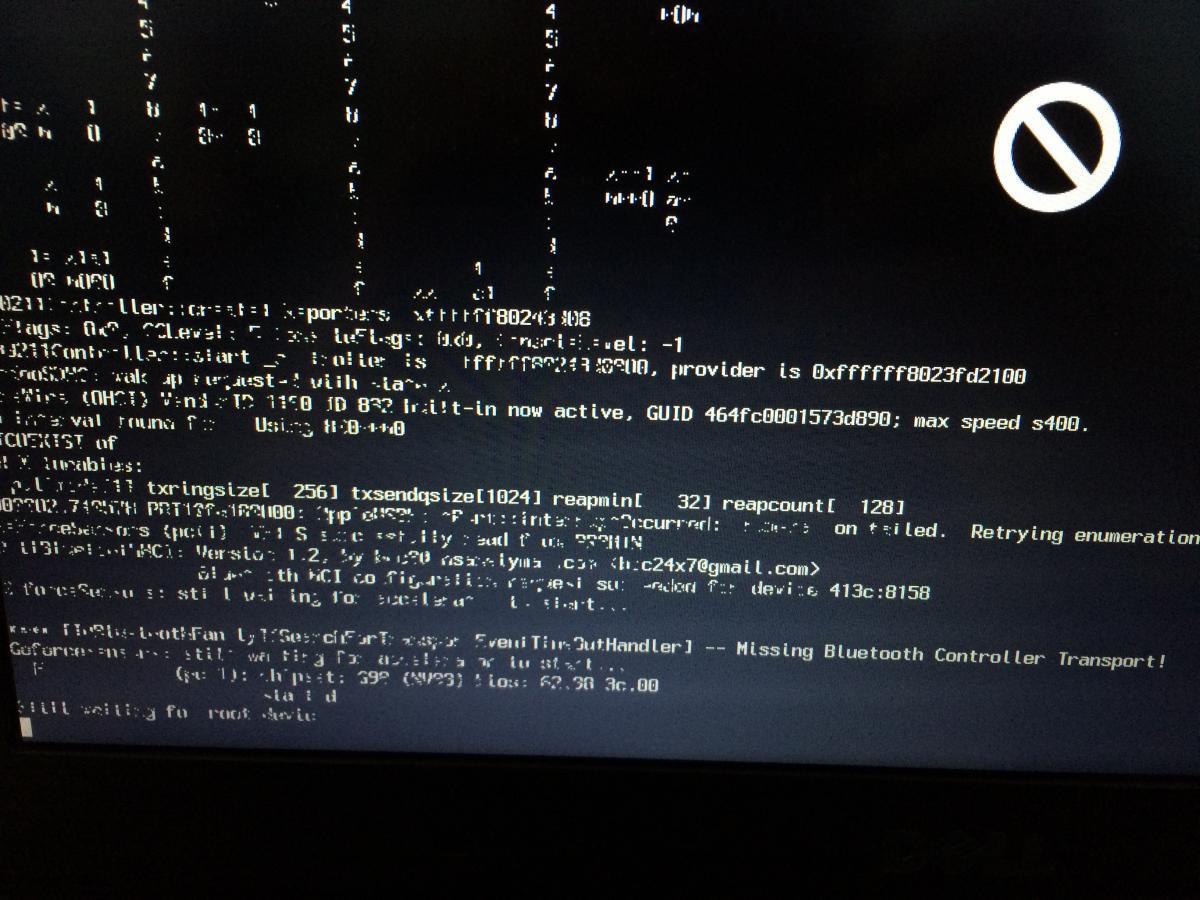

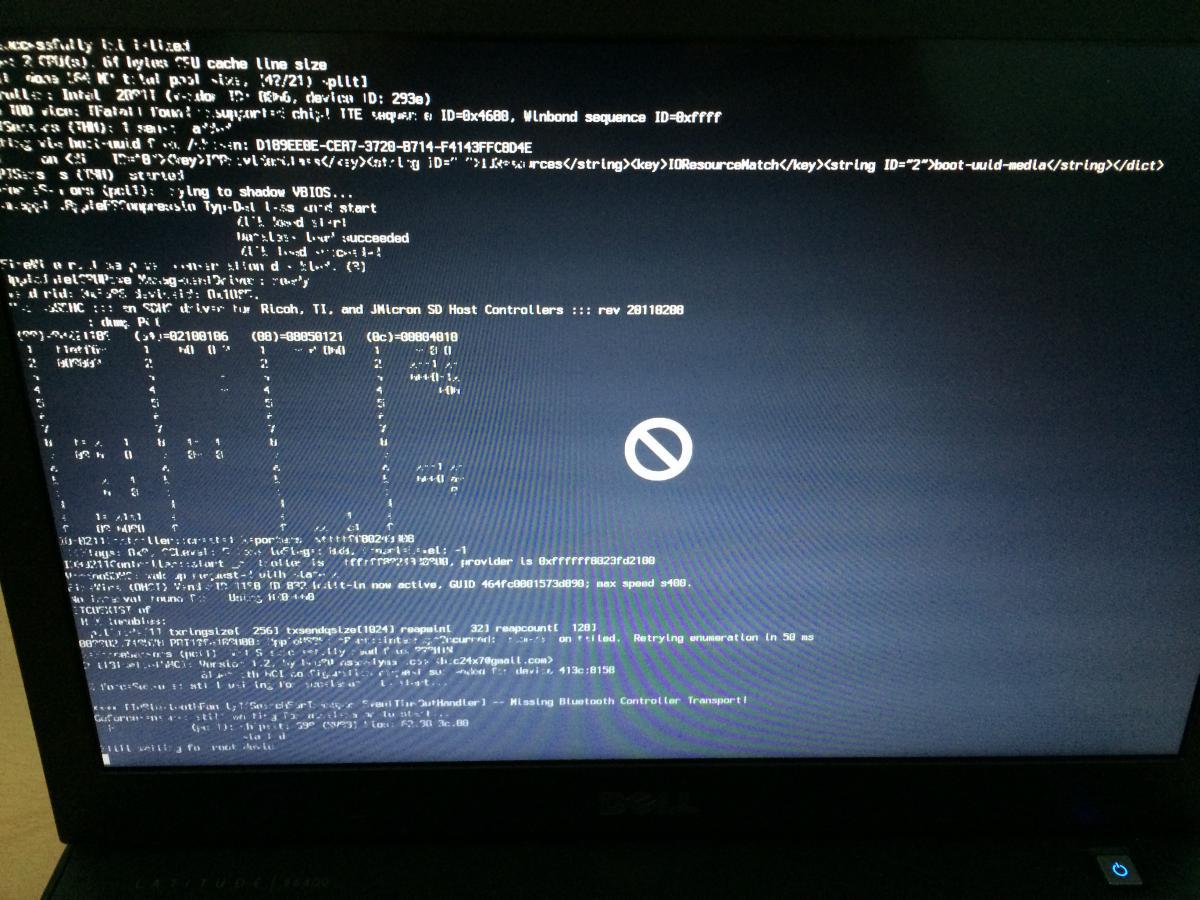

krzysztofc10 Posted June 9, 2015 Share Posted June 9, 2015 Hello! I'm trying to reach the installation of OS X 10.11 DP. But I'm ending on Still waiting for root device and error occured. My laptop Specs: Intel Core 2 Duo 2,8Ghz, 6MB Cache4Gb DDR2 800MHz160GB HDDNvidia Quadro NVS 160m 256mbDisplay 1440x900 resDell Wirelles 1510 card I format my pendrive to GUID OSX Journaled. Then restore basesystem.dmg. Delete Package alias in the System/Installation and replace with the Packages folder. Copy Payload and Basesystem.chunklist to root of my bootable USB. Install Clover Clover_v2.3k_SpecialEdition from InsanelyMac and copy my board id folder to /EFI/CLOVER/OEM. Then Im trying to boot osx but it gives me the error "Still waiting for root device" and screen flicker. Any suggestions ? I tried to run it with only fakesmc but the same error. 0X574R.zip Link to comment Share on other sites More sharing options...

krzysztofc10 Posted June 10, 2015 Author Share Posted June 10, 2015 I just paste all of my kext to Clover Kexts/Other and didn't use dsdt. Runing installation in -v, now it hang on FireWire..... Link to comment Share on other sites More sharing options...

wern Posted June 13, 2015 Share Posted June 13, 2015 Hello! I'm trying to reach the installation of OS X 10.11 DP. But I'm ending on Still waiting for root device and error occured. My laptop Specs: Intel Core 2 Duo 2,8Ghz, 6MB Cache 4Gb DDR2 800MHz 160GB HDD Nvidia Quadro NVS 160m 256mb Display 1440x900 res Dell Wirelles 1510 card I format my pendrive to GUID OSX Journaled. Then restore basesystem.dmg. Delete Package alias in the System/Installation and replace with the Packages folder. Copy Payload and Basesystem.chunklist to root of my bootable USB. Install Clover Clover_v2.3k_SpecialEdition from InsanelyMac and copy my board id folder to /EFI/CLOVER/OEM. Then Im trying to boot osx but it gives me the error "Still waiting for root device" and screen flicker. Any suggestions ? I tried to run it with only fakesmc but the same error. Copy your "kext/10.10" folder and rename it to "10.11", or copy the files to "other" folder, then edit your dsdt, search for EHCI and replace wit EHC1 3 Link to comment Share on other sites More sharing options...
gpatpandp Posted June 16, 2015 Share Posted June 16, 2015 This is the working solution. The panic/circle with a line in the middle was occurring due to the fact that the USB Installer was losing its connection as the E6400 has no working USB ports in OS X 10.11 El Capitan without making this edit in your dsdt.aml. Once the edit is made, the Installer will boot and the E6400 works just as well in El Capitan as it does in Yosemite. PS. Renaming the Kext folder is unnecessary and using Clover v2.3 r3215 is sufficient also. Link to comment Share on other sites More sharing options...
