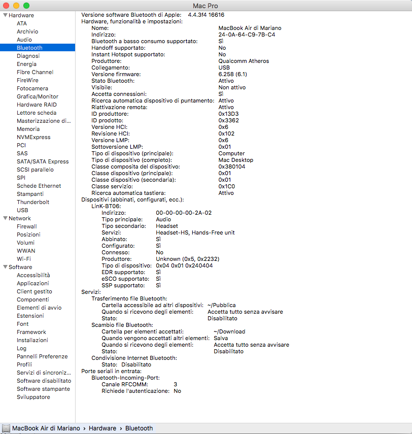

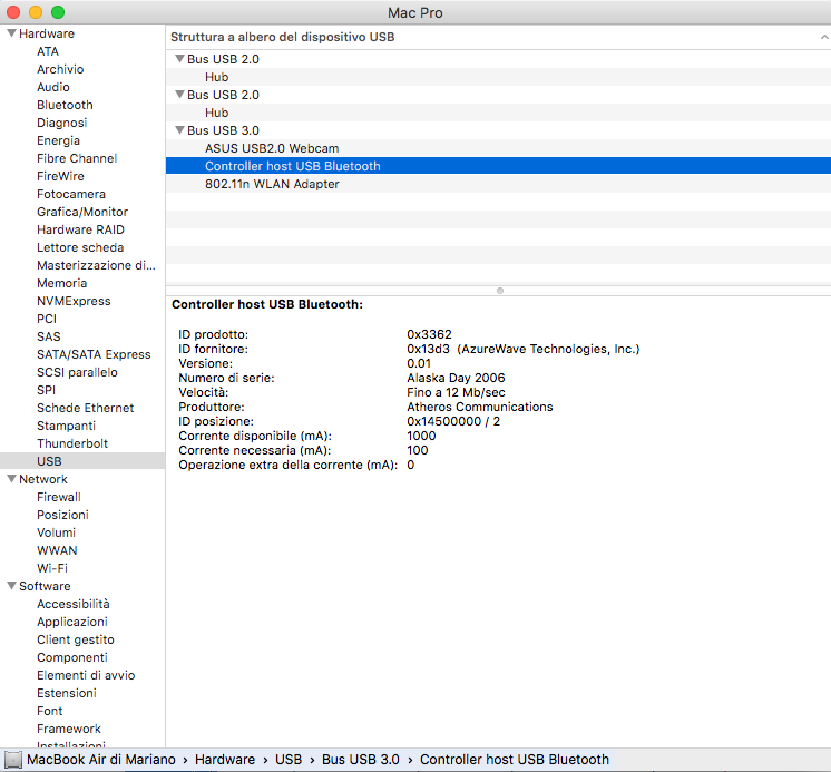

Administrators Hervé Posted March 18, 2016 Administrators Share Posted March 18, 2016 Can you post a screenshot of your SysProfiler Bluetooth and USB->Bluetooth info? Link to comment Share on other sites More sharing options...
mariano Posted March 18, 2016 Author Share Posted March 18, 2016 Here are screenshot: Thanks. Link to comment Share on other sites More sharing options...

mariano Posted March 18, 2016 Author Share Posted March 18, 2016 right now, I do not have menu for enabling and disabling, because if I put kext that allows this, when couple with a Bluetooth device (such as stereo) after a few seconds decouples alone .. (attaching the kext bluetooth) maybe perhaps there is something to be changed to prevent the bluetooth decouples alone. thanks. IOBluetoothFamily.kext.zip Link to comment Share on other sites More sharing options...
Administrators Hervé Posted March 18, 2016 Administrators Share Posted March 18, 2016 I don't know what was changed to the kext. Link to comment Share on other sites More sharing options...
Moderators Jake Lo Posted March 18, 2016 Moderators Share Posted March 18, 2016 Product and vendor ID change on Broadcom2045FamilyUSBBluetoothHCIController_D for the BroadcomBluetoothHostControllerUSBTransport.kext. Link to comment Share on other sites More sharing options...
