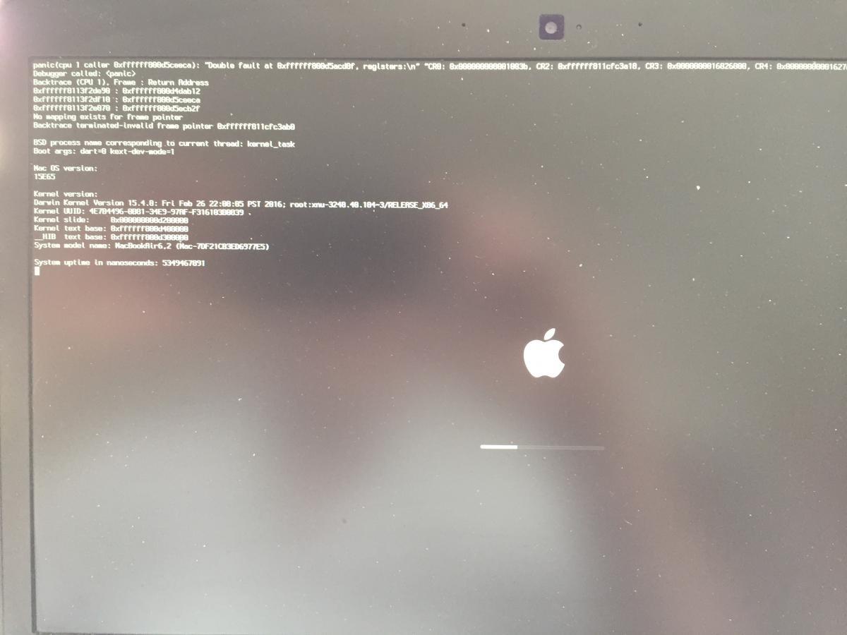

girardpallet Posted March 28, 2016 Share Posted March 28, 2016 Hello, i update my osX 10.11.3 to 10.11.4 without trouble(fix the sound), and for safety, i 've clone to my mSata , as usual ! but i don't know why, i not anymore able to boot from my backup. i have a kernel panic (see pict attached) can someone help me to find the reason? i'using clover last version, and able to boot to sata with OS X and mSata with win8, but not copie of OS X in mSata also. it was working find until now.... thank Link to comment Share on other sites More sharing options...

Administrators Hervé Posted March 28, 2016 Administrators Share Posted March 28, 2016 If it's anything like my E6220, E6320 or E6440, rebuilding cache won't change anything. I obtain this KP after installing the Recovery or Thunderbolt update after the 10.11.4 update. So, these may be best avoided.The only way I can reboot (sort of safely) is by limiting CPU to single core (using Enoch option cpus=1). Have not sussed out the problem yet, so only fix at my disposal for the time being is... to re-install! Link to comment Share on other sites More sharing options...

girardpallet Posted March 31, 2016 Author Share Posted March 31, 2016 ok, i make some progress, but not enough ok! if i remove the SATA disk, i'm able to boot, but only after one Kernel Panic.....??? i've try to repare permission, rebuilt the cache, but it didn't fix my problem. for repare i use: sudo /usr/libexec/repair_packages --repair --standard-pkgs / for rebuilt the cache , i use : sudo chmod -R 755 /Library/Extensions sudo chown -R 0:0 /Library/Extensions sudo chmod -R 755 /System/Library/Extensions sudo chown -R 0:0 /System/Library/Extensions sudo touch /System/Library/Extensions sudo kextcache -Boot -U / i'm now reformat my Sata 1To with usb adapter, and clone my mSata to usb...... result in a moment.... no progress, stil same .... if only mSata is connected , able to boot only after 1 KP..... if i connect also my sata hard drive, kernel panic every boot..... any help would be precious! thank Link to comment Share on other sites More sharing options...
Administrators Hervé Posted March 31, 2016 Administrators Share Posted March 31, 2016 Stick to 10.11.3 and/or do not install Recovery + Thunderbolt updates with 10.11.4. Link to comment Share on other sites More sharing options...
