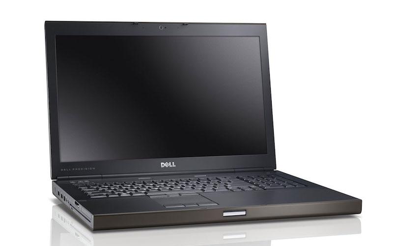

Pupilliam Posted July 7, 2016 Share Posted July 7, 2016 Specifications: Processor : Intel Core i7-2720QM @ 2.20GHz Graphics : Nvidia Quadro 3000M / Intel HD3000 Chipset : Intel QM67 Espress Hard Disk : 256GiB SanDisk SSD RAM : 16GiB 1333MHz WiFi : Dell Wireless 1510 Bluetooth : None Ethernet : Intel 82579LM Gigabit Audio : IDT 92HD90 Audio Touchpad : ALPS Touchpad Monitor : 17.3" HD (1920 x 1080) Card Reader : Ricoh Bootloader : CloverUEFI Ports: 1 x Microphone 3.5 mm 1 x Headphone 3.5 mm 1 x USB/eSATA 1 x VGA 1 x DisplayPort 1 x HDMI 1 x Thunderbolt 2 x USB 2.0 2 x USB 3.0 Working: Graphics with QE/CI on Nvidia Quadro 3000M | Native, better performance with web drivers, disable Optimus USB 2.0 | USB-inject-all USB 3.0 | GenericUSBXHCI Touchpad & Keyboard | VoodooPS2 Battery | ACPIBatteryManager SpeedStep | SSDT Required & AppleIntelCPUPowerManagement Audio | VoodooHDA Ethernet Not working: Sleep SD Reader VGA and HDMI | Haven't tested Other Notes: OS Configuration: Windows 10 on the mSATA port, Sierra on an SSD. Clover is installed to the mSATA SSD. EDIT: For anyone interested, I'll be writing a guide here soon with more progress on my hackintosh. I have to start over fresh from Windows, so I'll let you know how that goes. EFI.zip 1 Link to comment Share on other sites More sharing options...
