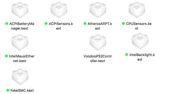

itjedi42 Posted November 13, 2016 Author Share Posted November 13, 2016 I believe I have also tried that voodoops2 kext with a similar KP issue. Here is whats in my /EFI/CLOVER/Kexts/Other folder. Possible theres a conflict? and not necessarily the AppleHDA_IDT or VoodooPS2controller.kext causing it? Edit: Ignore VoodooPS2controller.kext in screenshot, took the screenshot from the backup of EFI I took before upgrading to 10.12.1 Link to comment Share on other sites More sharing options...

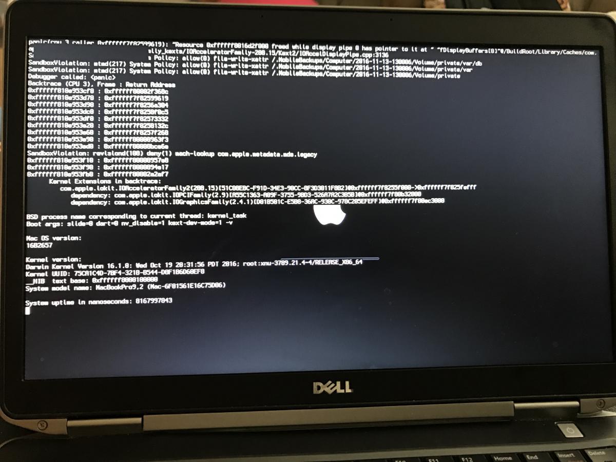

Administrators Hervé Posted November 13, 2016 Administrators Share Posted November 13, 2016 You're gonna have to post a picture of your KP or tell us what it says... If you use Clover, make sure to select AsusAICPUPM or you'll get KP on CPU power management. That's mandatory on all Sandy Bridge and Ivy Bridge laptops. If you re-use the Clover config.plist from a previous version, the existing set of binary patches may also be the source of the KP. It'd be a good idea to post your complete EFI folder. Link to comment Share on other sites More sharing options...
itjedi42 Posted November 13, 2016 Author Share Posted November 13, 2016 Here is the KP capture. This is with the values you gave me for patching. And the 10.11.4 AppleHDA_IDT.kext from the original guide in /L/E Link to comment Share on other sites More sharing options...
Administrators Hervé Posted November 13, 2016 Administrators Share Posted November 13, 2016 I think you've got an obsolete IOGraphicsFamily patch in your config.plist. I did ask your EFI folder, but... The IOGraphicsFamily patch for Sierra is: Find: 0100007525 Replace by: 010000EB25 1 Link to comment Share on other sites More sharing options...
